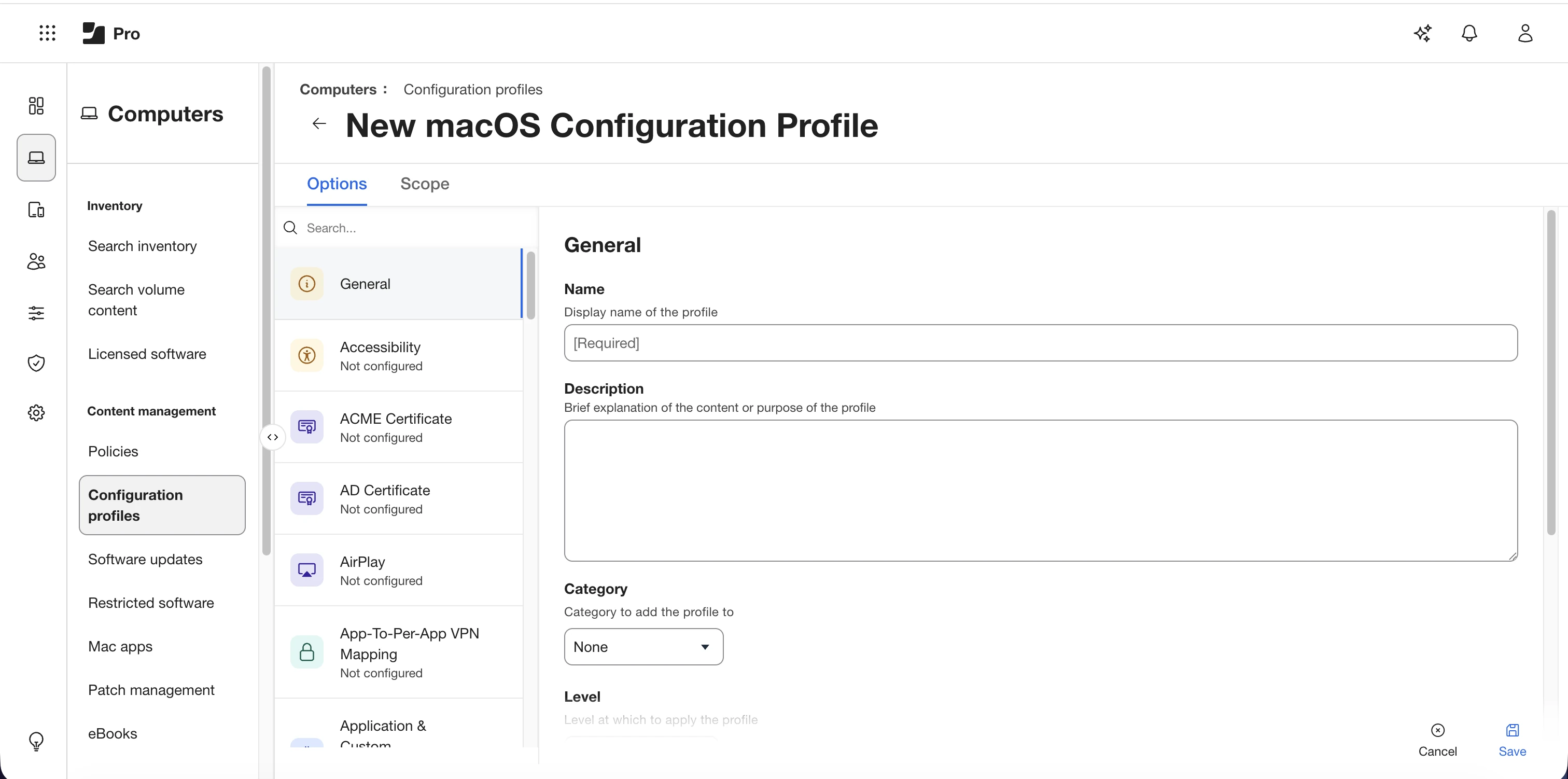

Step 1 – Open the Jamf Pro account and log in using your credentials.
Step 2 – In your Jamf account, from the main navigation bar click Computer, and then from the left sidebar menu, select Configuration Profiles.
Step 3 – To create a new configuration profile, in the upper right, above the table with available configuration profiles, click +New.
Creating a New configuration Profile
On the New macOS Configuration Profile section, you can manage profile settings and select the devices and users to which you want to deploy the profile.
General Settings​
Click Save only after you have managed all settings and the profile scope.

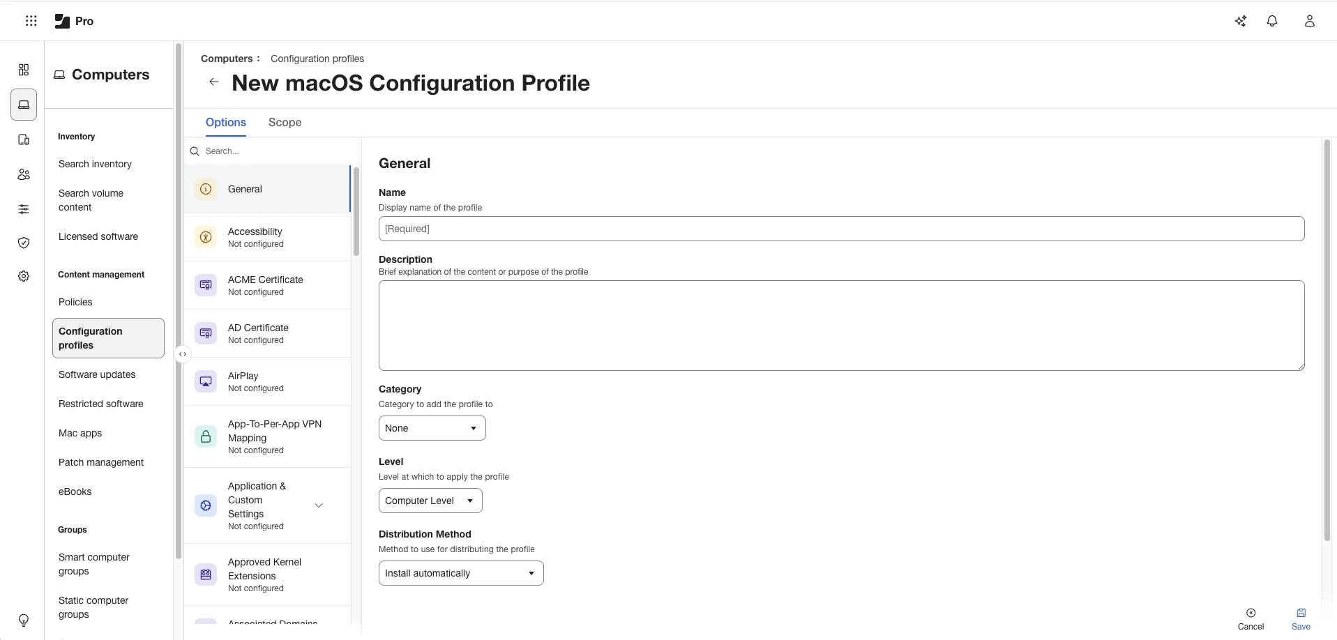

On the default General section, enter the following information:
  • Name – enter a name to use for this configuration profile.
  • Description (optional) – add a description that details the purpose of the configuration profile.
You can continue with the default settings for the category, level, and distribution method fields.
Completing information on the general section

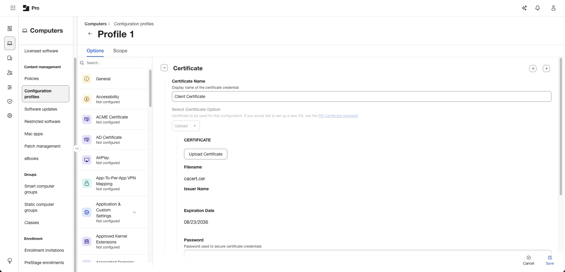

Certificate Settings​
You will add the Client CA Certificate in .cer format on the Certificate settings section.
This step isn't required if you aren't using Deep Package Inspection. To continue the process, go to the Privacy Preferences Policy Control section.

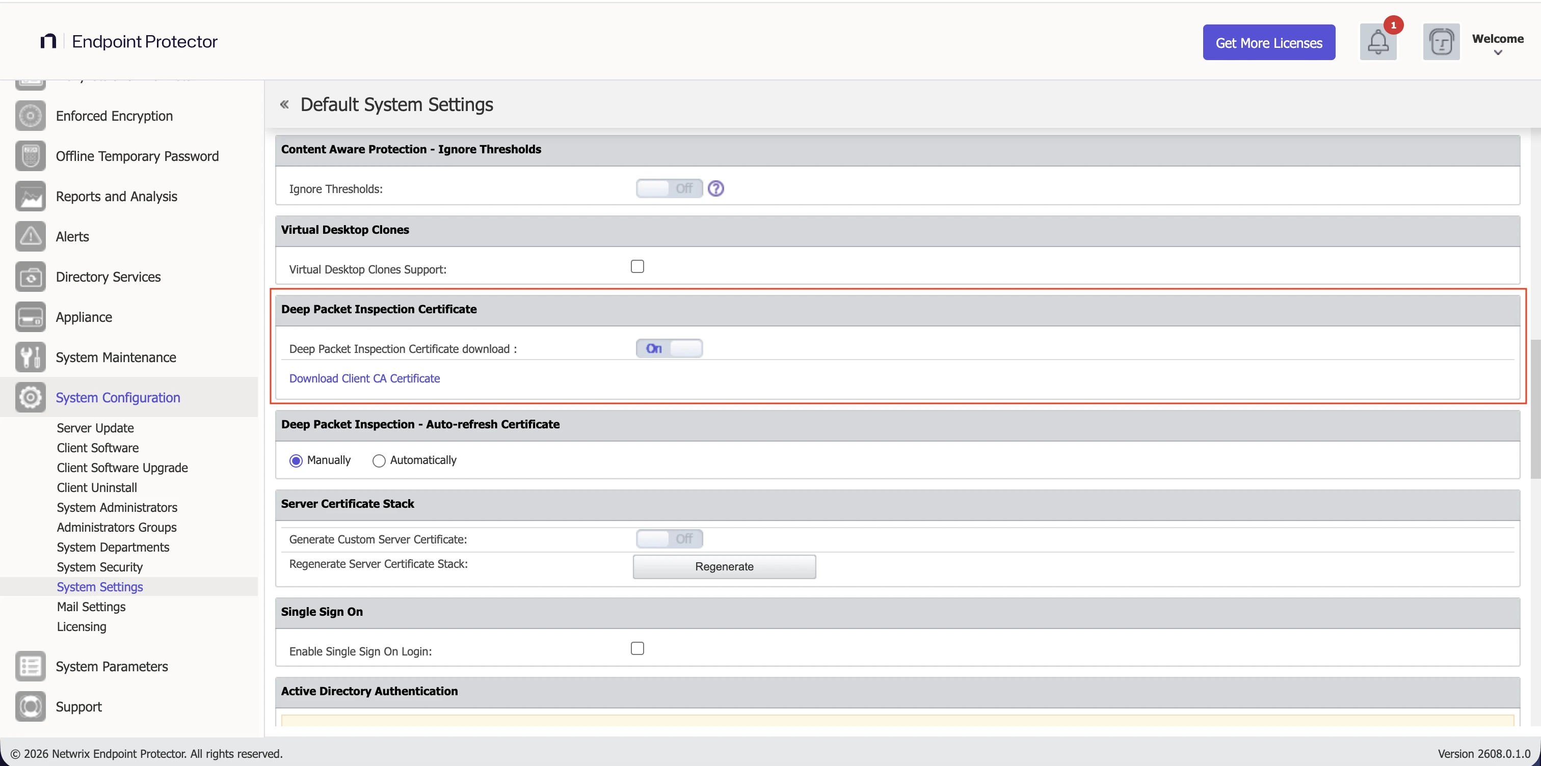

Step 1 – Log in to Endpoint Protector Server, go to the System Configuration section, and then select System Settings.
Step 2 – On the Default System Settings section, enable Deep Packet Inspection Certificate and then download Client CA Certificate – the downloaded .zip file contains the .cer and .crt client certifications.
Enabling Deep Packet Inspection Certificate and then downloading Client CA Certificate
Step 3 – Return to Jamf and go to the Certificate section of the profile you created earlier, and then click Configure.
Step 4 – Enter a Certificate name and then select and upload the downloaded Client CA Certificate in .cer format.
Step 5 – Save the changes.

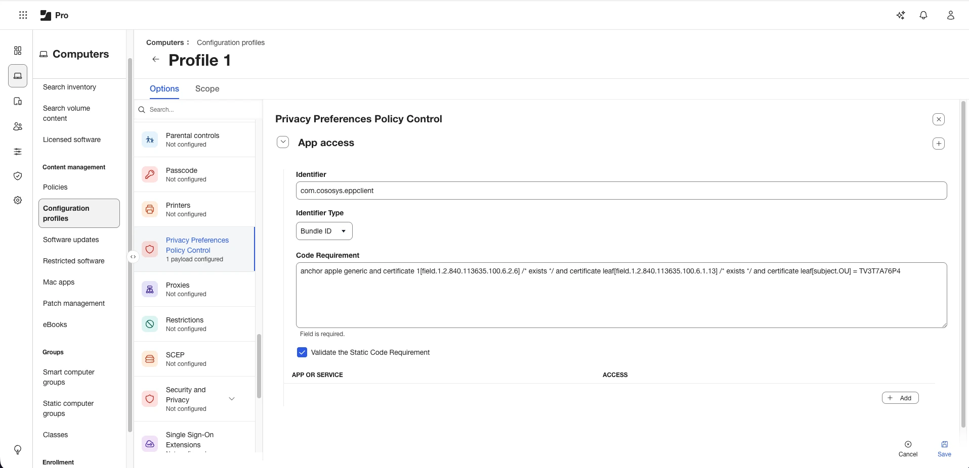

Privacy Preferences Policy Control Settings​
Edit the profile you created earlier, go to the Privacy Preferences Policy Control section, click Configure, and then enter the following information:
  • Identifier - com.cososys.eppclient.
  • Identifier Type – go with the default Bundle ID type.
  • Code Requirement
anchor apple generic and certificate 1[field.1.2.840.113635.100.6.2.6] /* exists */ and certificate leaf[field.1.2.840.113635.100.6.1.13] /* exists */ and certificate leaf[subject.OU] = TV3T7A76P4.
Use the Terminal Editor to verify there are no formatting alterations before executing this command line.
  • Select the Validate the Static Code Requirement check-box.
  • Click Add and Save to allow access to SystemPolicyAllFiles and Accessibility services.
Jamf may list Accessibility as (Deprecated) in this dropdown. Apple has publicly earmarked this service for retirement, so Jamf flags it ahead of time. You can still select it — this is an advance notice, not a functional issue.
Configuring Privacy Peferences Policy Control

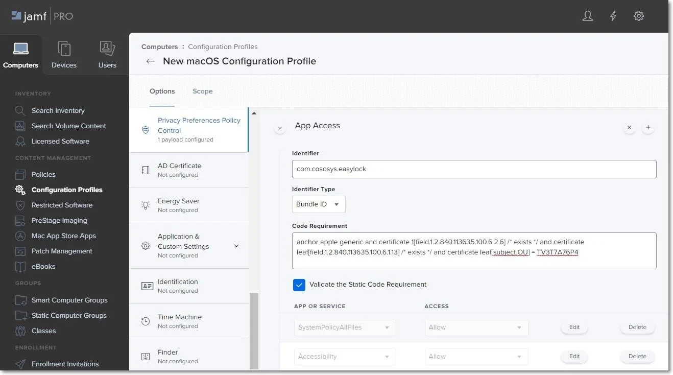

Enforced Encryption Settings​
On the Privacy Preferences Policy Control section, click the + icon to add a new policy and then enter the following information:
Identifier – com.cososys.easylock.
Code Requirement
  • Click Add and then Save to allow access to SystemPolicyAllFiles and Accessibility services.

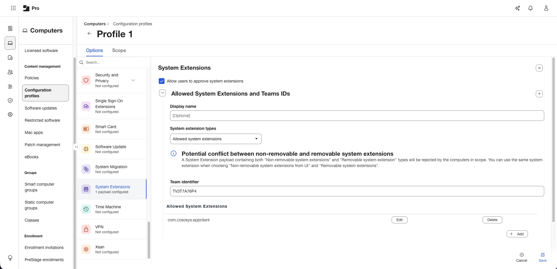

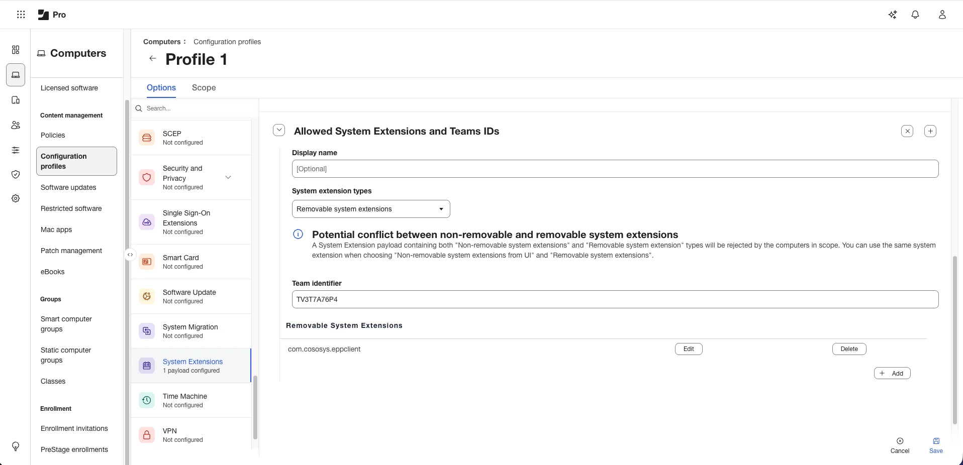

System Extension Settings​
Allow System Extensions​
On the System Extension section, click Configure and then enter the following information:
  • Display Name (optional) - enter a name to use for this configuration.
  • System Extension Type - select Allow System Extension type.
  • Team Identifier - TV3T7A76P4.
  • Allowed System Extensions – click Add, enter com.cososys.eppclient, and then Save the changes.
Allowing System Extensions
For operating systems lower than macOS 11 (Big Sur), manage settings from the Approved Kernel Extensions section instead of System Extensions. Define the Team ID (enter TV3T7A76P4) and proceed to the next step.
Removable System Extensions​
On the System Extension section, click the + icon to add a new policy that will allow removing system extensions without a pop-up, and then enter the following information:
  • System Extension Type - select Removable System Extensions type.
This setting applies starting with MacOS 12 (Monterey).
Adding a new policy that will allow the removing of system extensions

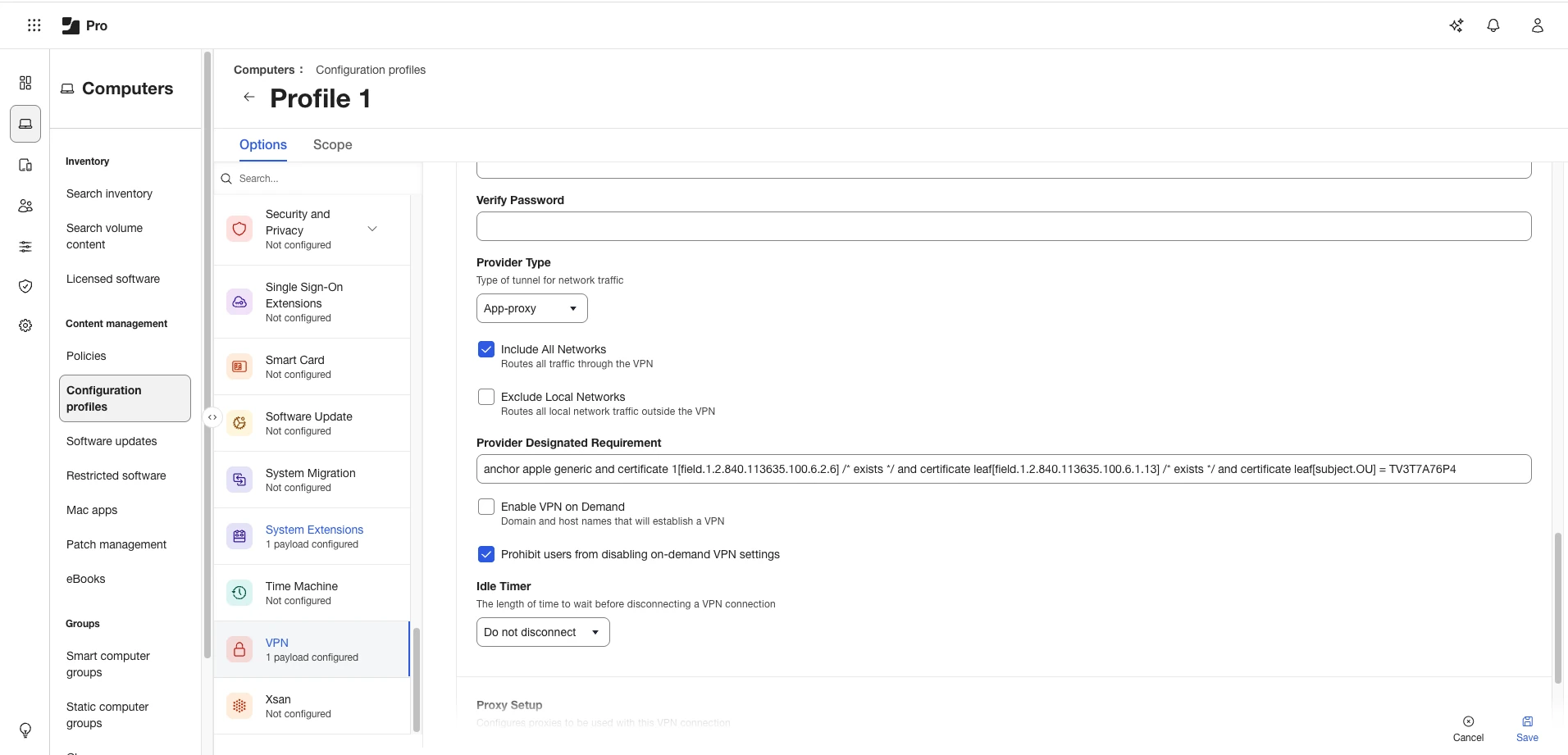

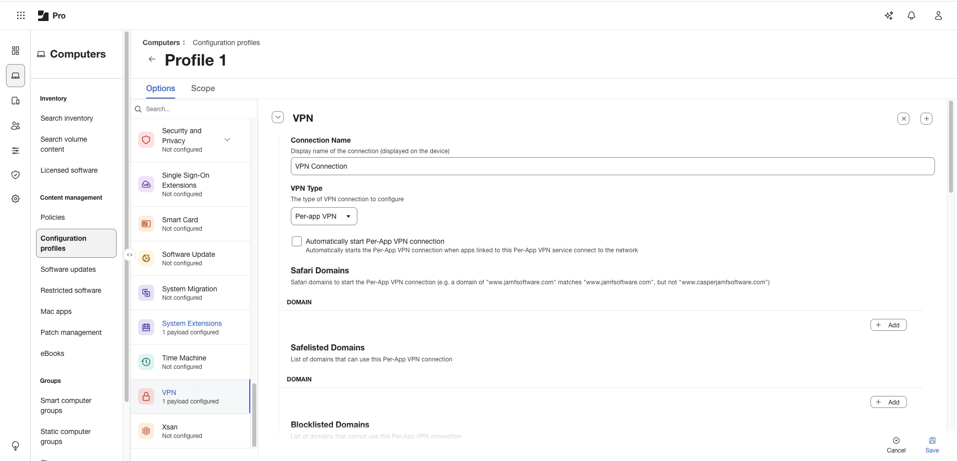

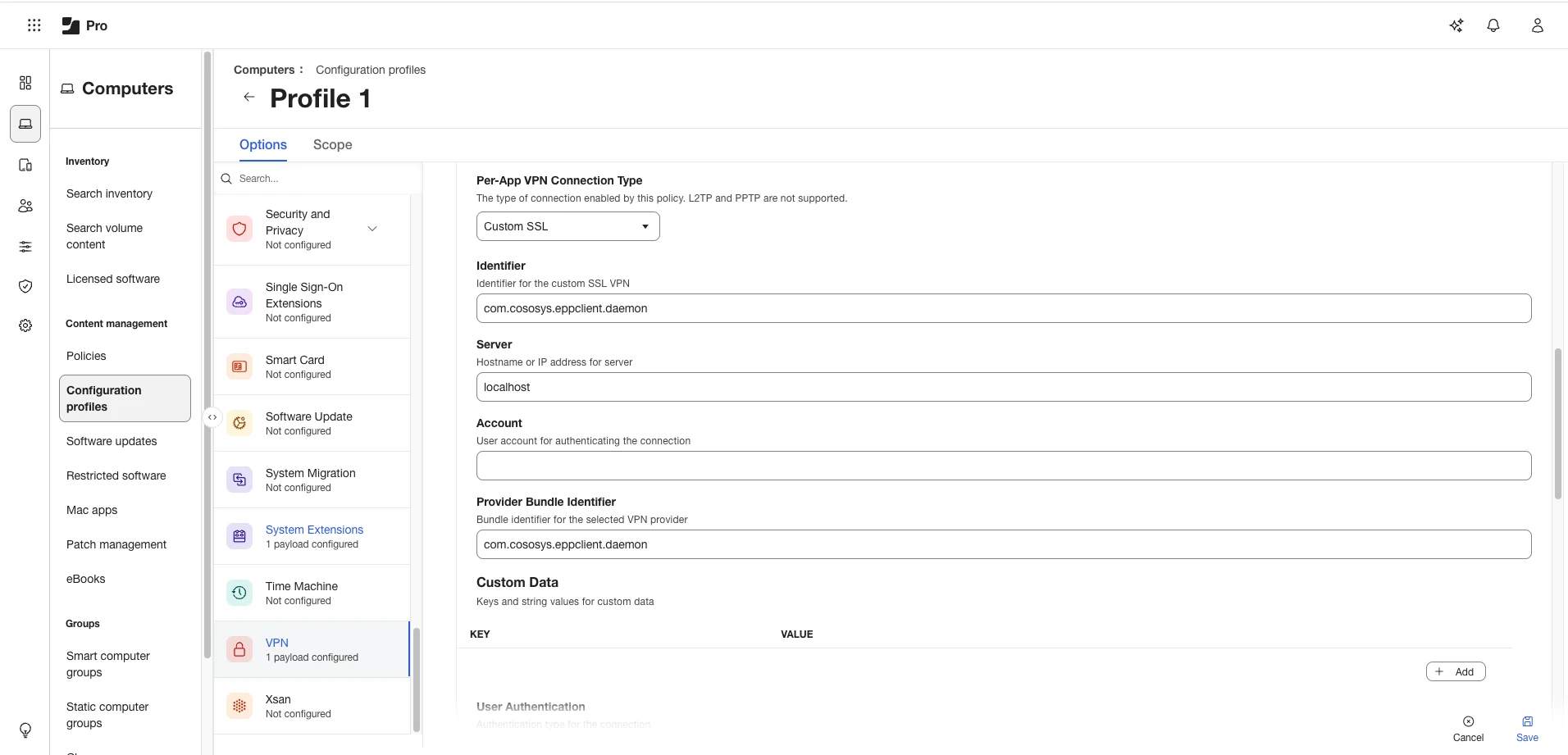

VPN Settings​
This step isn't required if you aren't using VPN services. To continue the process, go to the Scope section.
On the VPN section, click Configure and then enter the following information:
  • Connection Name – enter a connection name that will be displayed on the device.
  • VPN Type – select Per-App VPN type.
  • Per-App VPN Connection Type – select Custom SSL connection type.
  • Identifier – com.cososys.eppclient.daemon.
  • Server – localhost.
  • Provider Bundle Identifier – com.cososys.eppclient.daemon.
  • Provider Type – select App-proxy type.
  • Select the Include All Networks check-box.
  • Provider Designated Requirement
  • Select the Prohibit users from disabling on-demand VPN settings check-box.
First section to configuring VPN settings
Second section to configuring VPN settings
Third section to configuring VPN settings

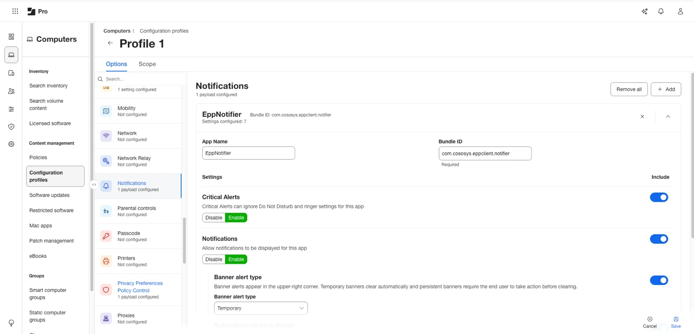

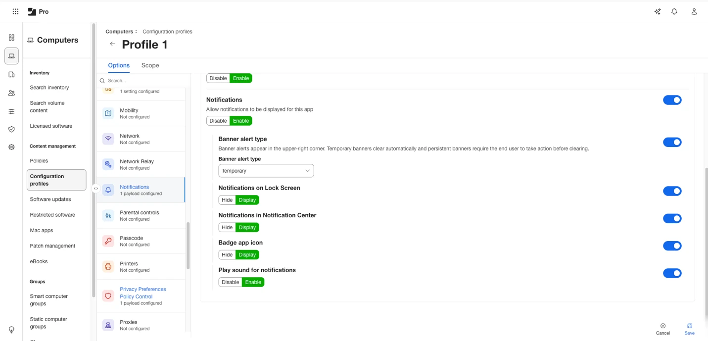

On the Notifications section, click Configure and then enter the following information:
  • App Name - EppNotifier.
  • Bundle ID - com.cososys.eppclient.notifier.
  • Toggle the switch to include the settings type and then disable/enable to manage each notification option.
Optional Notifiaction Settings
Optional Notifiaction Settings continued

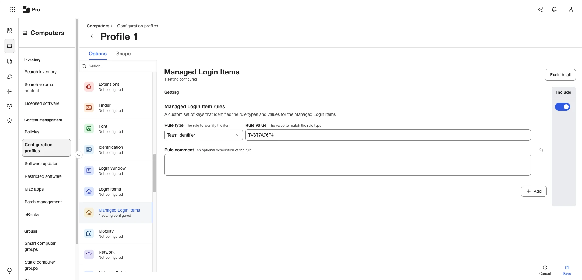

On the Managed Login Items section, click Configure and then enter the following information:
  • Rule Type – select Team Identifier.
  • Rule Value – TV3T7A76P4.
  • Enable the Include toggle.
Configuring Managed Login Items

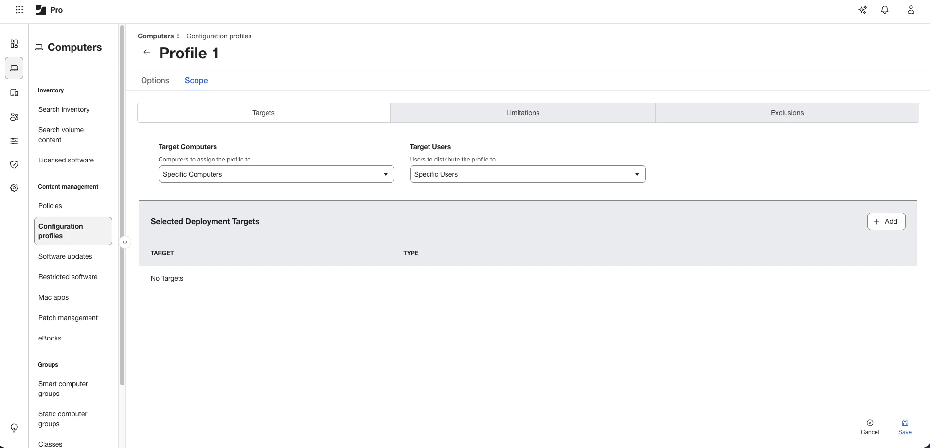

After you manage all settings, go to the Scope tab and select the devices and users to deploy the new profile.
Click Save to apply all settings to the new configuration profile.
To confirm that the new configuration profile is saved successfully, reboot your computer at this point.
Selecting Devices and Users to deploy to the new profile.
