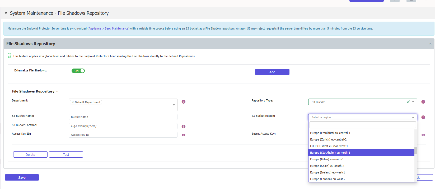

S3 Bucket File Shadow Repository
The Amazon S3 bucket is a public cloud object storage resource available from Amazon Web Services (AWS) Simple Storage Service (S3).
S3 Bucket type File Shadow Repository supports large files up to 5TB (AWS specification).

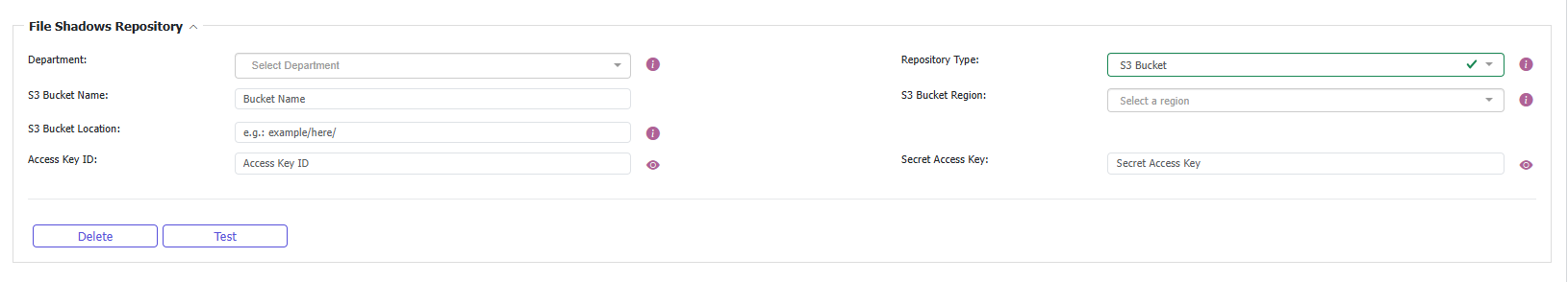

To create an S3 Bucket type File Shadow Repository on Endpoint Protector, provide the following information:
- Repository Type – select S3 Bucket as the type of repository
- Department – assign one or more departments to the File Shadow Repository
- S3 Bucket Region – depending on the artifacts retrieval method, select one of the options from the drop-down list or add a bucket region corresponding with the AWS S3 Bucket settings
- S3 Bucket Name – add a name for the bucket repository corresponding with the AWS S3 Bucket settings
- S3 Location – add a specific sub-folder location in the AWS S3 Bucket
- Access Key ID – add the Key for S3 Bucket corresponding with the AWS S3 Bucket settings
- Secret Access Key – add the Token Key generated for a user corresponding with the AWS S3 Bucket settings
