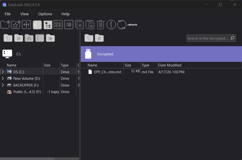

Enforced Encryption, Formerly known as EasyLock, is a cross-platform solution that protects data with government-approved FIPS 140-3 validated encryption. For USB devices, it needs to be deployed on the root of the device. With the intuitive Drag & Drop interface, files can be quickly copied to and from the device.

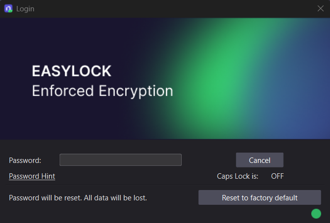

Enforced Encryption works on read-only mode if the device was formatted on Windows, the Enforced Encryption configured on Windows or some files were encrypted on Windows. On macOS, these files can be decrypted, except for NTFS due to incompatibility with Enforced Encryption.

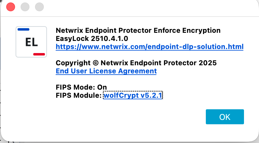

Enforced Encryption 140-3 FIPS Validated Engine
Starting with Netwrix Enforced Encryption version 3.0.0.2 (5.9.4.2 release), a new encryption engine has been introduced, replacing the previous 256-bit AES CBC-mode encryption with FIPS 140-3 validated cryptography. This FIPS 140-3 validated encryption provides the highest standards of data protection, ensuring compliance with the latest industry regulations. While the new encryption engine is fully backward compatible for existing users, allowing for a seamless upgrade and continued use of previously encrypted drives, USB sticks encrypted with the FIPS 140-3 validated engine will not be compatible with older Enforced Encryption Clients. Therefore, we recommend updating EE Clients to ensure compatibility.
To verify the version of the 140-3 FIPS validated engine and view certification details, check the "About" section in the Enforced Encryption application.

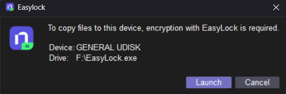

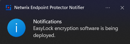

Deployment can be done automatically if Allow Access if Trusted Device™ Level 1+ is selected for the USB Storage Devices. This can be done by going to Device Control, Global Rights section, or using the quick links provided, as per the image above.
Manual deployment is also available. Download links for both Windows and Mac are available in this section. The downloaded Enforced Encryption file must be copied onto the USB storage device and executed from the root of the device. Due to extended security features for manual deployment, Enforced Encryption will have to be redownloaded from the Endpoint Protector interface each time it will be used to encrypt a new USB storage device.

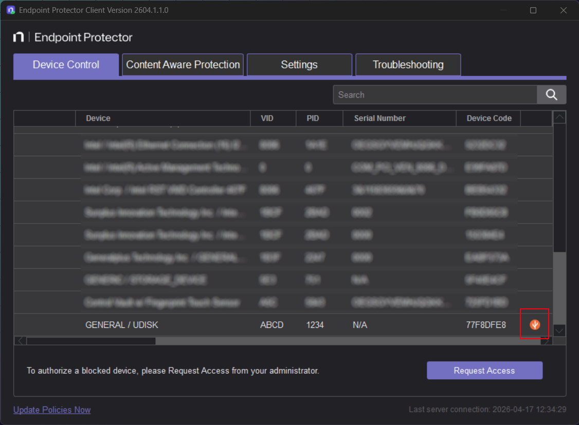

Starting with Endpoint Protector 5.2.0.0, manual deployment can also be made by the user if the device is set on Allow Access, by pressing the small USB icon- Encrypt Device with Enforced Encryption.

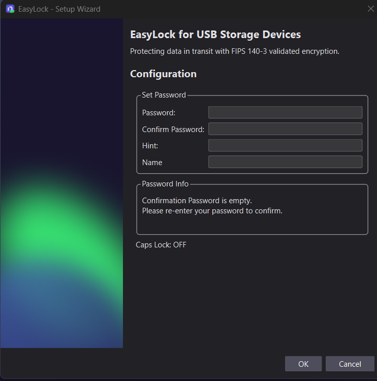

Both Enforced Encryption deployments are straightforward and require the user only to configure a password.

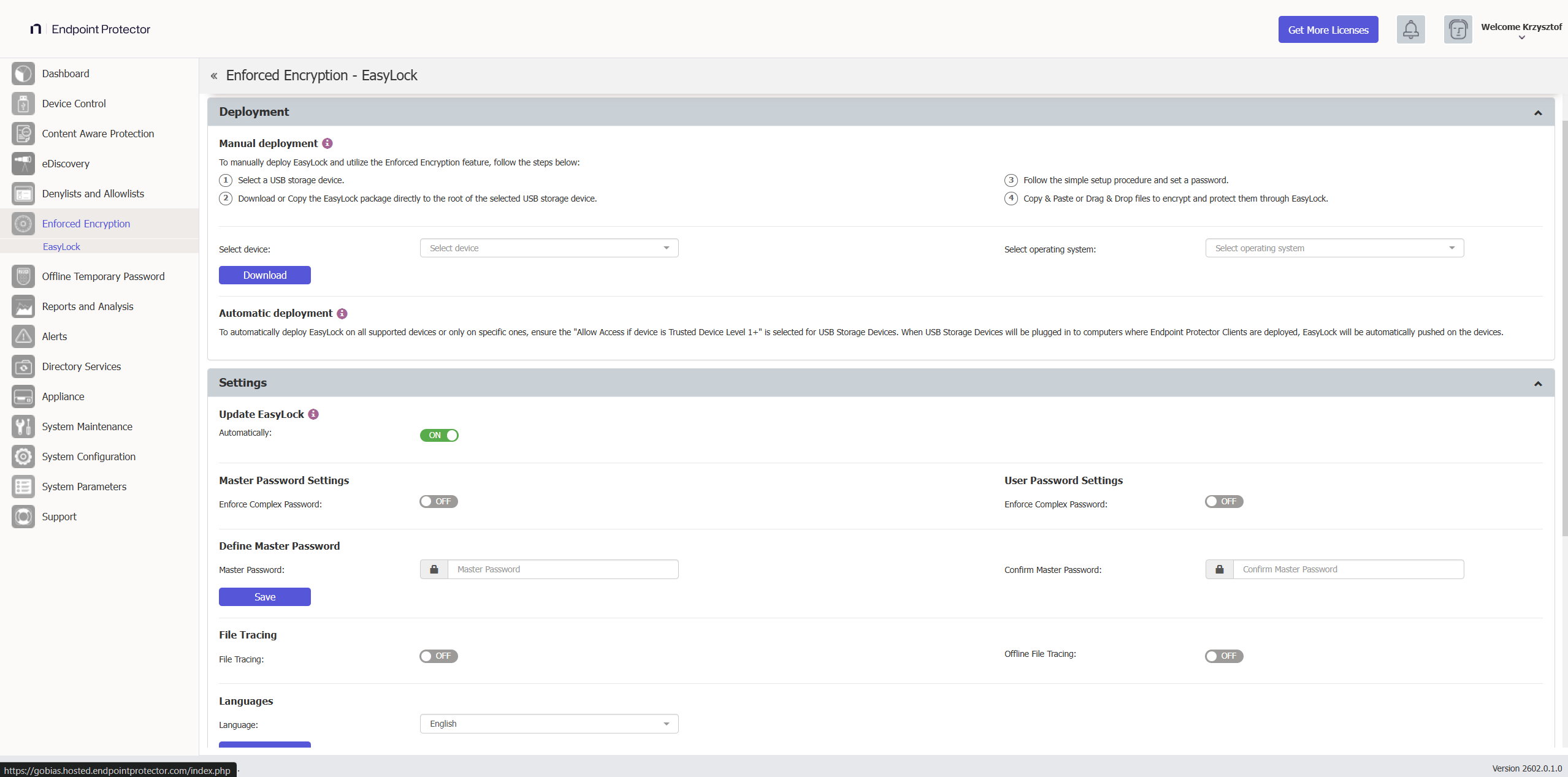

Enforced Encryption Settings
This section allows you to remotely manage Enforced Encryption encrypted devices. Before being able to take advantage of these features, you must configure a Master Password.
In the Settings section, the Master Password can be configured, the Enforced Encryption File Tracing enabled, as well as defining the installation and execution of Enforced Encryption only on computers where the Endpoint Protector Client is present.
For both the Master Password and the User Password, complex rules can be enforced. If these are enabled, the password lengths, minimum characters, validity, history, and other settings can be set.

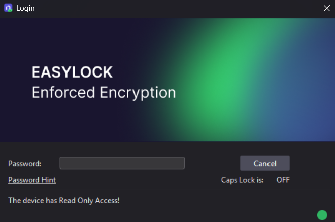

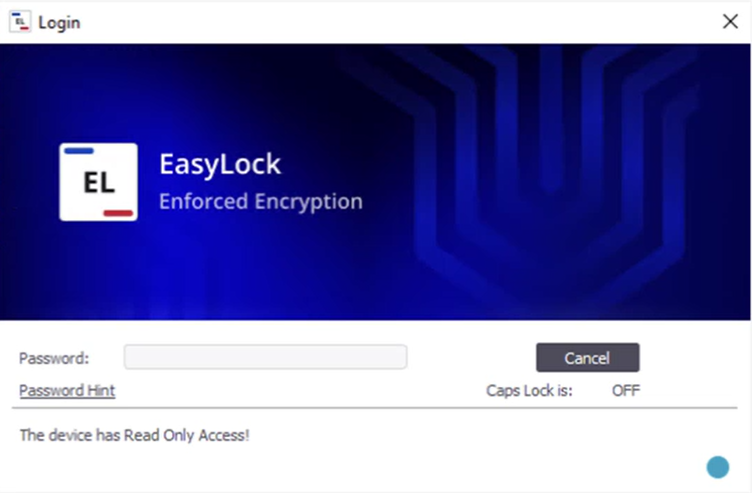

Enforced Encryption in Read-Only mode
Netwrix Enforced Encryption Read-Only Mode for unmanaged computers is an innovative feature designed to maintain data security standards across non-corporate devices. It allows administrators to grant access to EE encrypted drives on personal computers, conference room setups, or exhibition areas while ensuring security through a Read-Only configuration. This enables the seamless transfer of corporate data across different environments, providing robust protection without sacrificing accessibility.
To activate this mode, navigate to the "Global Settings" section related to Enforced Encryption, and switch on the "EE Read-Only mode" toggle. Please refer to Global Settings - EE configuration.
