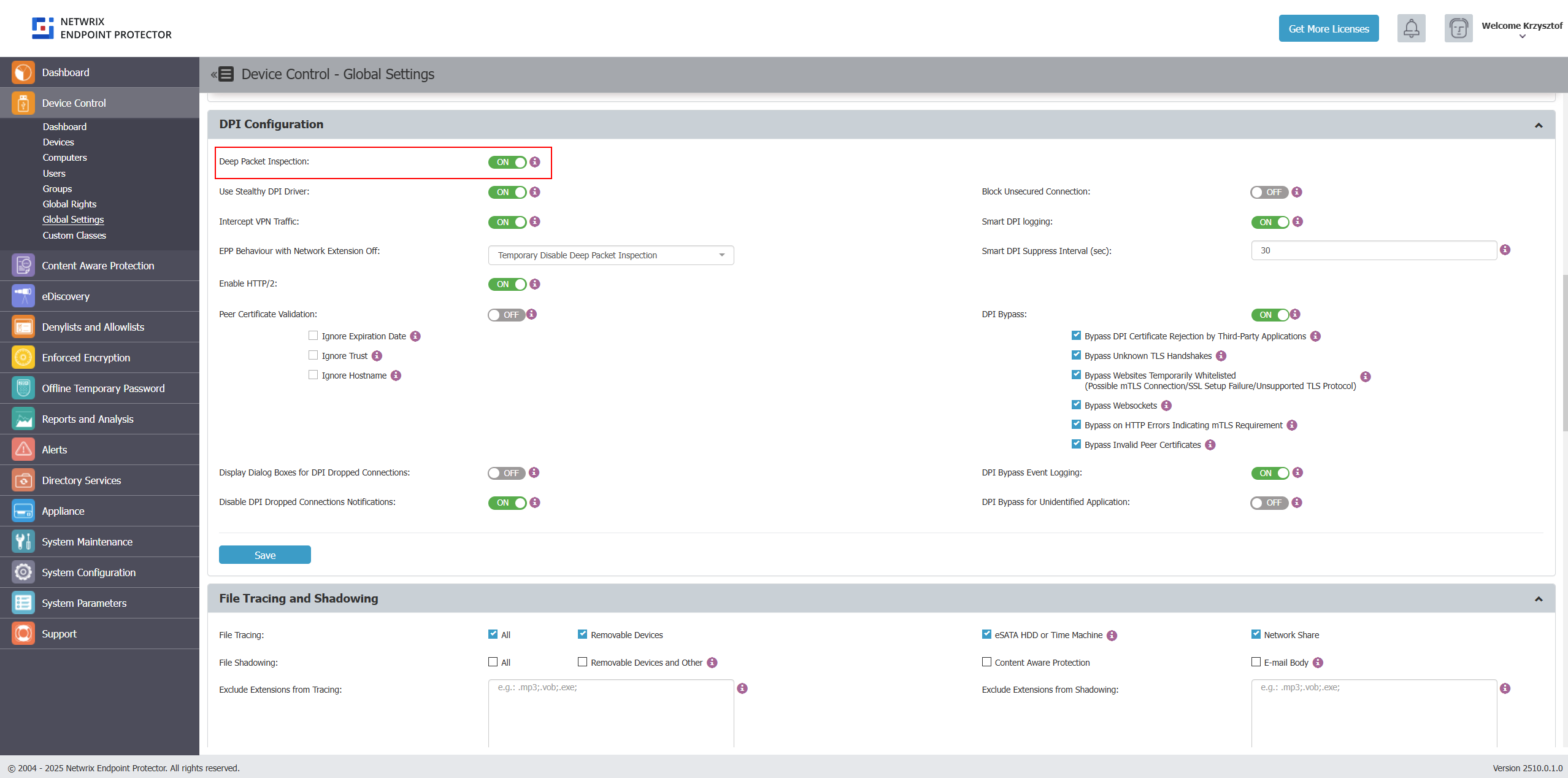

Step 6 – Open the Endpoint Protector Server and activate Deep Packet Inspection by navigating to Device Control > Users/Computer/Group/Global Settings > Manage Settings > Endpoint Protector Client > Deep Packet Inspection.
Activating Deep Packet Inspection
