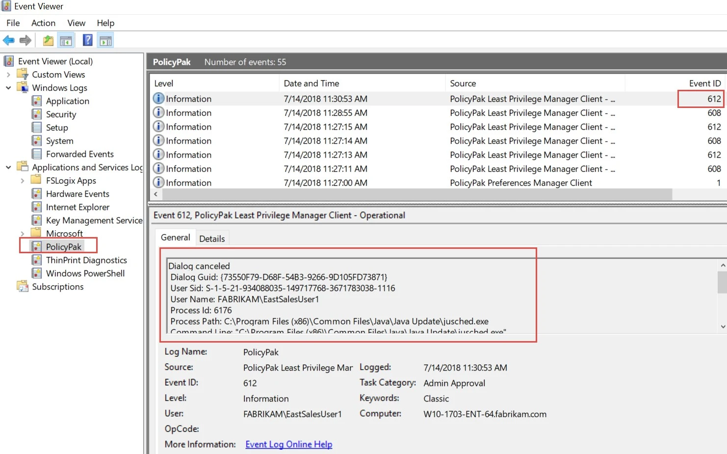

Using Endpoint Policy Manager Event Logs to Find and Overcome Unwanted Pop-ups
You can get similar information from the Endpoint Policy Manager event logs, which are found in the Application and Services Logs > Endpoint Policy Manager. An event will appear showing canceled dialogs, like the one shown here.
There is more information on using Event Viewer with Endpoint Policy Manager at the end of this guide, with specific event IDs to search for.
