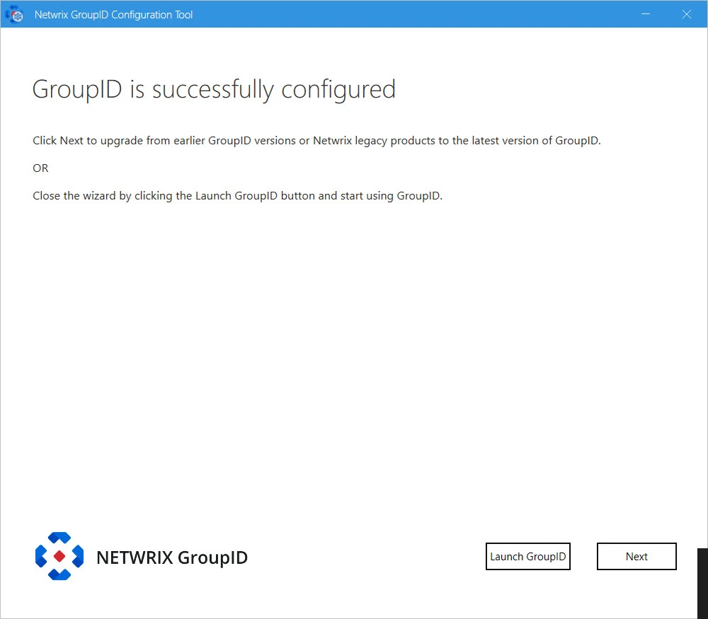

If you are running the Configuration Tool on a machine that had a prior Directory Manager version and the Signing Key utility isn't applied on that Directory Manager on that machine. The Configuration Tool will change the Signing Key and displays a disclaimer message on the Directory Manager is successfully configured page as follows:
GroupID is successfully configured page with Signing Key Disclaimer

Step 1 – Run the Configuration Tool on the master node of the cluster. It will change the Signing Key on the master node and display a disclaimer message on the Directory Manager is successfully configured page as shown in the Single Directory Manager instance section.

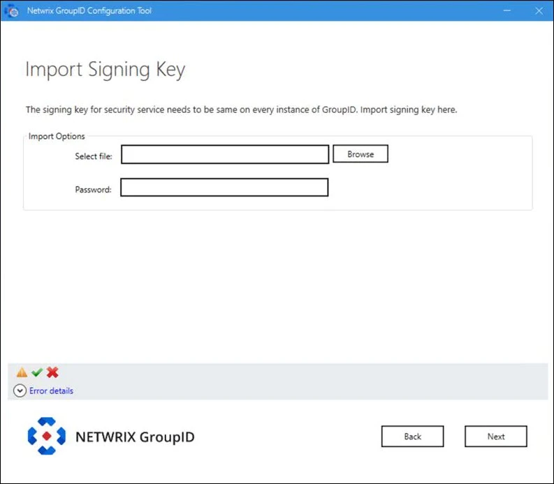

Step 4 – Run the Configuration Tool on the slave node until you reach the Import Signing Key page of the wizard:
  1. Click Browse next to the Select file box to browse to the folder where you have copied the Signing Key file.
  2. Provide the password of the Signing Key file in the Password box.
  3. Click Next.
Step 5 – The Configuration Tool displays the Directory Manager is successfully configured page without the disclaimer.

Step 4 – Run the Configuration Tool on instance 2 and 4 until you reach the Import Signing Key page of the wizard.
  3. Click Next.
