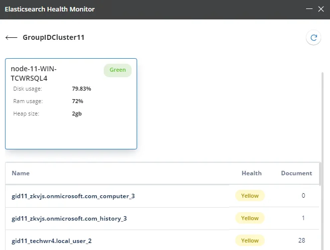

To view Elasticsearch health status:
In Admin Center, click Replication in the left pane.
On the Replication page, click Elasticsearch Health Monitor.
This dialog box lists the Elasticsearch clusters in your environment, with the following information for each cluster:
Health: the cluster health status denoted by the following colors:
- Green – the service is running and the cluster is intact. Moreover, two or more nodes exist within the cluster.
- Yellow – the cluster is running but with warnings. It also indicates that a single node exists within the cluster. Elasticsearch recommends a three-node topology for improved performance and high availability.
- Red – the service has stopped or the cluster is broken (for reasons such as network connectivity.
Nodes: the number of nodes in the cluster.
Master: the name of the master node in the cluster.
To refresh the information displayed, click the Refresh icon.
Click a cluster name to view it in detail.
This dialog box displays the total number of nodes in the cluster. Each node is represented by a card, that displays the following for the node:
The name of the node
The system resources the node uses, such as hard disk space, RAM, and heap size
Node health with respect to disk space usage, denoted by the following colors:
- Green – when hard disk space usage is 79.99% or less
- Yellow – when hard disk space usage is 80-89.99%
- Red – when hard disk space usage is 90% or more
The indices in the cluster are listed in the gird.
The Name column displays the names of the indices.
The Health column displays the health of the index, which is denoted by the following colors:
- Green – the index is replicated to all nodes within the cluster.
- Yellow – the index is replicated to some but not all nodes within the cluster.
- Red – the index is not replicated to any node within the cluster.
The Document column shows the number of documents in the index.
Click the back arrow to return to the Elasticsearch Health Monitor dialog box.
