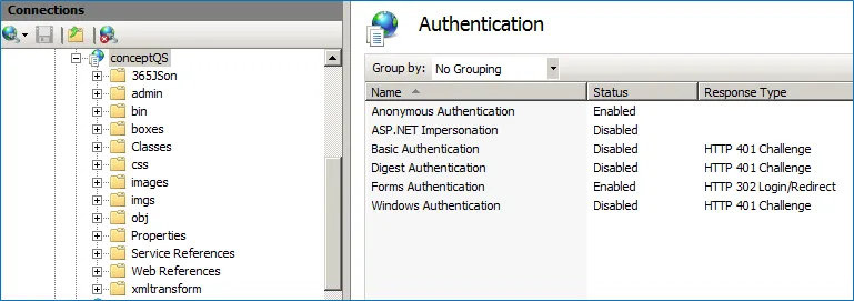

On first install, the QS defaults to Windows authentication. To set up the QS to use an ADFS server, follow the "Installation and Configuration" guide using the section "ADFS". To use forms based authentication, disable all other authentication methods in IIS other than: Anonymous and Forms:
To use authentication forms:
Step 1 – Check that the “authentication mode” setting in conceptQS/web.config file is set as follows:
(This is the default setting.)
Step 2 – Check that the Authentication settings are correct in IIS for Windows Authentication:
The NDC web application must have these authentication methods enabled:
- Anonymous Authentication
- Windows Authentication
Disable all other authentication methods.
Step 3 – If you want to allow anonymous access to NDC, edit the conceptQS web.config file and delete (or comment out) three lines:
If these lines are present, users must log in using their Windows credentials.

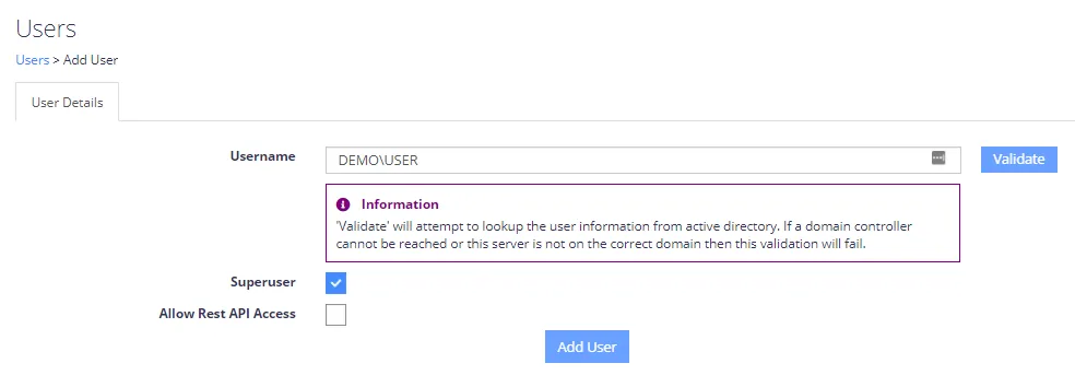

Add or Remove Users
You can add and remove users via the Users screen at any time.
You can validate additional Windows users using Integrated Windows Authentication. You can only add additional non-Windows users if the Non-Windows Authentication mode is enabled.
If you delete the only Super User, the system removes all security and reverts the QS administrative functions to unrestricted access.
User accounts with REST API access are still restricted by their specific permissions. A Super User with REST API access will be able to run any API method. Any normal user will be restricted by the same rules that govern the UI. Further API samples and documentation can be found at: /NDC/_api

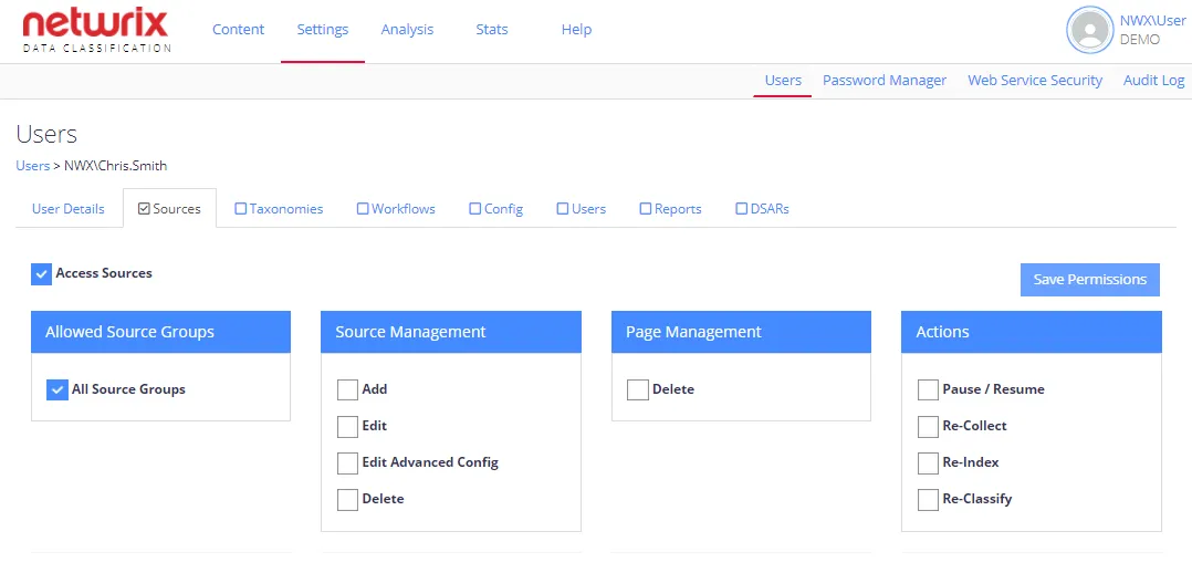

To allocate granular permissions to a user (non-Super Users), click Edit on their row in the Users table. The permissions for each section of the administrative web interface will be displayed as tabs. Each tab contains a top-level checkbox of the form "Access [Area Name]” (e.g. Access Sources) which defines whether a user has access to each of the top level administrative areas.
When an area is enabled there are typically more granular permissions that can be enabled, such as:
- Within the Taxonomies area, you can also assign permissions at a specific Term Set or Term branch level. A full user permission summary (for all Term/Set level permissions) can be viewed by selecting the View Taxonomy Permissions button.
- Within the Sources area, you can restrict a user’s access to specific source groups, as shown in the following image.
