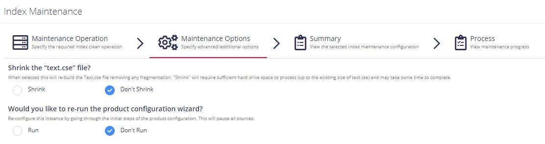

Step 2: Maintenance Options
Specify options for the operation you have selected.
Operation selectedAvailable optionsDetails
Rebuild IndexShrink the "text.cse" file?
  • Shrink
  • Don't Shrink (default)
Selecting Shrink will rebuild the Text.cse file, removing any fragmentation. Shrink will require sufficient disk space to process (up to the existing size of Text.cse) and may take some time to complete.
All operationsWould you like to re-run the product configuration wizard?
  • Run
  • Don't Run (default)
Select Run if you want to re-configure this instance by going through the initial steps of the product configuration. This action pauses all sources.
