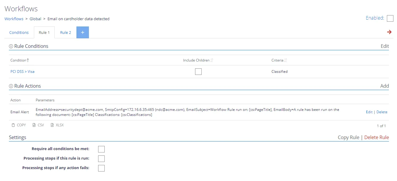

Specifying Rule Conditions
  1. In the corresponding section on the Rule tab, click Edit on the right. The Edit Rule Conditions dialog opens.
  2. From the Mode list, select how the conditions should be applied.

  4. Specify what logic to use when applying the filtering terms:
  • To apply AND logic (i.e. the document must match all filters), select Require all conditions be met.
  • Otherwise, OR logic will be used (i.e. the document must meet any of the filtering conditions).
  1. Verify the filtering term appears in the Edit Rule Conditions window in blue. Click Save.
The configured rule condition appears in the Rule Conditions section on the Rule tab.
add_workflows_rules_list_thumb_0_0
Example
If you want to apply the rule to all documents classified as Visa cardholder data using PCI DSS taxonomy, configure the rule condition as follows:
  1. From the Mode list select Specific Conditions.
  2. Select Classified option.
  3. In the Select Term, click the tag icon.
  4. In the Details window, from the Taxonomy list select PCI DSS.
  5. In the tags hierarchy, select Visa and click OK.
add_workflows_advanced_details_thumb_0_0
Ensure the filtering term is displayed in the Edit Rule Conditions window with blue color. Click Save.
The configured rule condition will appear in the Rule Condtions section on the Rule tab.

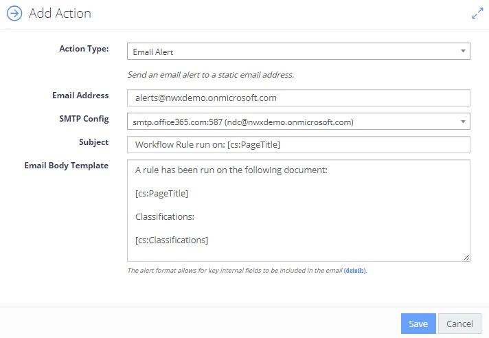

Specifying Rule Actions
  1. In the corresponding section on the Rule tab, click Add on the right. The Add Action dialog opens.
  2. From the Action Type list, select the action to apply to documents that match the rule conditions. For details, see Workflow Actions.
  3. Click Save.
add_workflows_advanced_action_thumb_0_0
