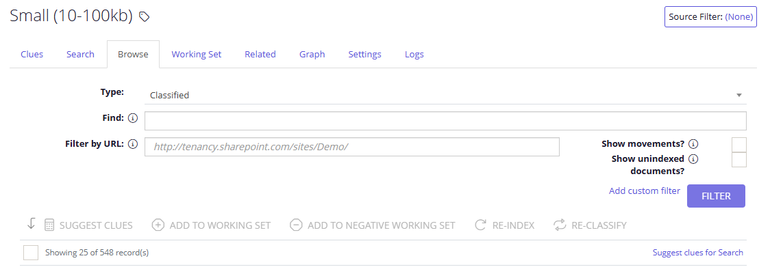

Documents can be added to the Working Set from the Search or Browse tabs by using the Add to Working Set links:
browsetab_thumb_0_0
