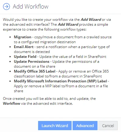

To create an automated workflow for certain type of documents, you can use the Add Workflow wizard or Advanced dialogs.
To launch the Add Workflow wizard:
- In the administrative web console, select Workflows from the top menu.
- Click the Workflows tab.
- Click the Add button in the upper right corner.
- In the dialog displayed, click the Launch Wizard button.

NOTE: Once created you will be able to modify the workflow using the Advanced dialog.
Alternatively, take steps 1-3 from the procedure above, then in the Add Workflow dialog click Advanced. See Configuring Workflows Using Advanced Dialog
