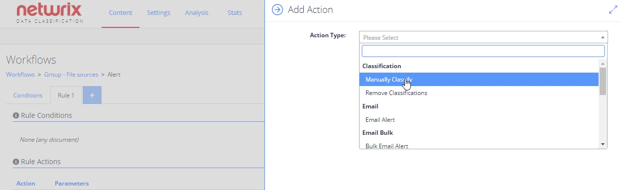

To apply additional classification:
In the Add Action dialog, from the Action Type list select Manually Classify under Classification, then configure the necessary terms as described below.
NOTE: The terms you select must belong to a single taxonomy / termset.
To remove all classifications:
In the Add Action dialog, from the Action Type list select Remove Classifications under Classification.
