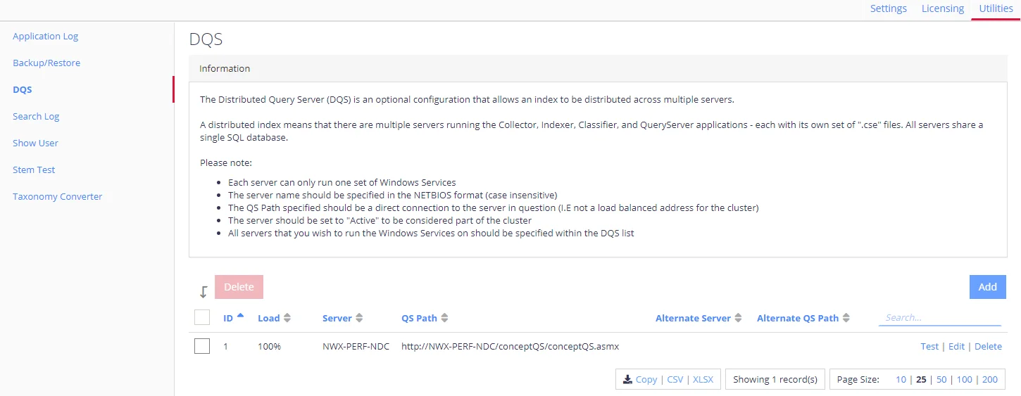

  3. Navigate to Settings → Utilities → DQS.
  4. Select Enable DQS.
    NOTE: Once the DQS mode is enabled, you cannot roll back your configuration. Netwrix strongly recommends to ensure that you have taken a full backup of your environment. If ready, confirm the DOS enablement operation when prompted.
  5. On the DQS tab, click Add to add servers you prepared, one by one.
    dqs_mode_page_thumb_0_0

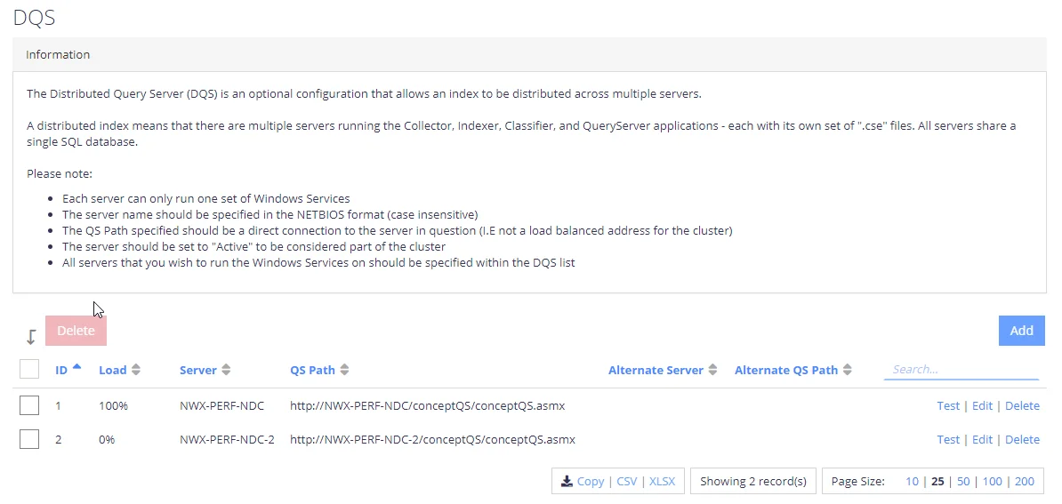

  2. Repeat steps 2 - 6 for every NDC Server, then review the list of servers to make sure the new server was included.
dqs_servers_list_thumb_0_0
