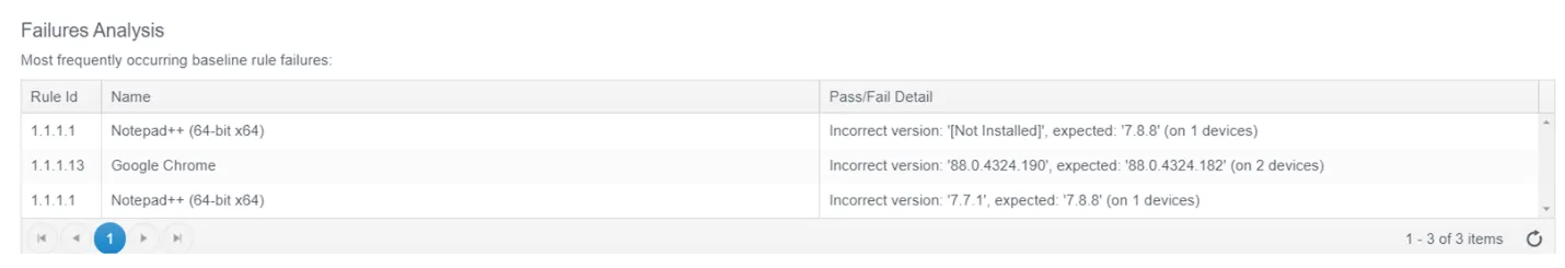

For example, from my worked example earlier, there were three failures reported. One device was missing a required item (Notepad++) and one other device was running the wrong version of Notepad++. These failures would be remediated by installing or updating the software on the two non-compliant devices. However, there was also a third failure – Google Chrome has been reported on the same two devices at a later version than required.
There are two paths to take from this: The two devices showing failures should be downgraded to match the required version, alternatively, it may be preferable to update the Baseline Configuration to embrace the newer version? This is a process known as 'promoting to the baseline' where either a new or updated element needs to be grafted into the existing Baseline to take into account changing times. Netwrix Change Tracker makes this process straightforward too, using the Manage Tab.

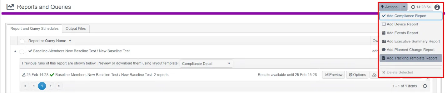

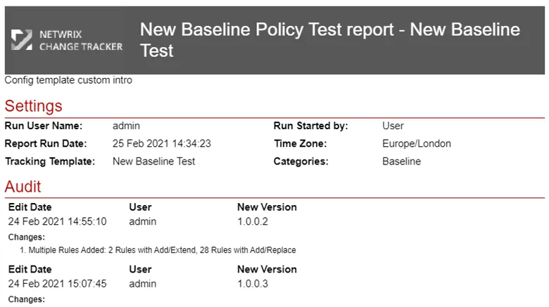

To get a ‘hard copy of the Baseline Policy, you can create a Tracking Policy report based on the Baseline Policy. Go to the Reports Center and use the Actions button, then select Add Tracking Template Report.
An Auditor will often ask to see what the Baseline Policy comprises, when and why changes have been made and by whom. This report provides a complete audit trail of changes as well as the breakdown of rules included in the policy.
