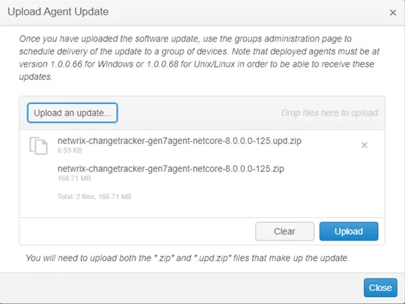

An agent update is comprised of two zip files. One is a new set of program files, the other is a upd file, which signs the update to confirm its integrity.
The Agent Updates page can be found in the Settings menu. The Actions button on this page has an option to Upload an Agent Update.
The resulting dialog facilitates the upload of the agent update files.

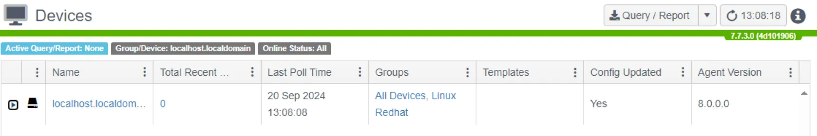

Check the Devices tab to ensure that updates have been deployed as expected.
