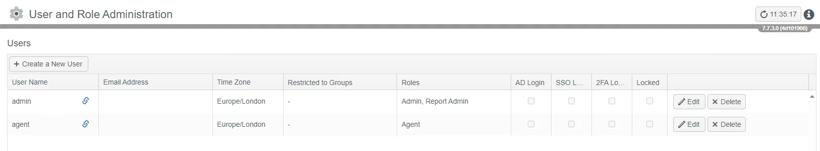

During installation of the Hub, an account named Agent is created with just the Agent role. This role enables agents to use this account to authenticate with the Hub. As the agent account has no other roles, it can only be used by agents to authenticate.
Rotate Agent Credentials
The existing agent account can be seen in the Users section of the Hub.
Changing the password of an account used by agents to authenticate will cause the agents to go offline as they will be attempting to authenticate with the old password.
For a smooth transition, it is recommended to create a new account with just the Agent role. This account will have a different user name and password. Once created, the agent's configuration can be updated to use the new account. When all agents have been migrated, the old agent account can be removed.
Follow the steps to create the new agent account.
Step 1 – Click Create New User, give it a user name and just the Agent role.
Step 2 – Click Update, and the User Password dialog opens with a complex password. This is only shown once. It is recommended that this be saved in a password management system for future use.

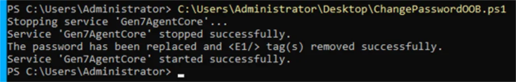

Running the script will set the new authentication details and restart the agent while producing the output below.

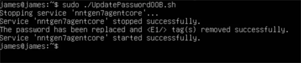

Running the script will set the password and restart the agent while producing the output below.
