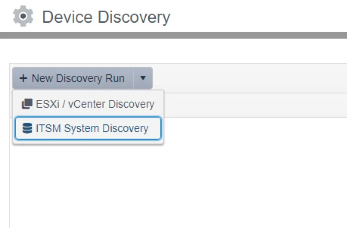

Follow the steps to configure Device Discovery.

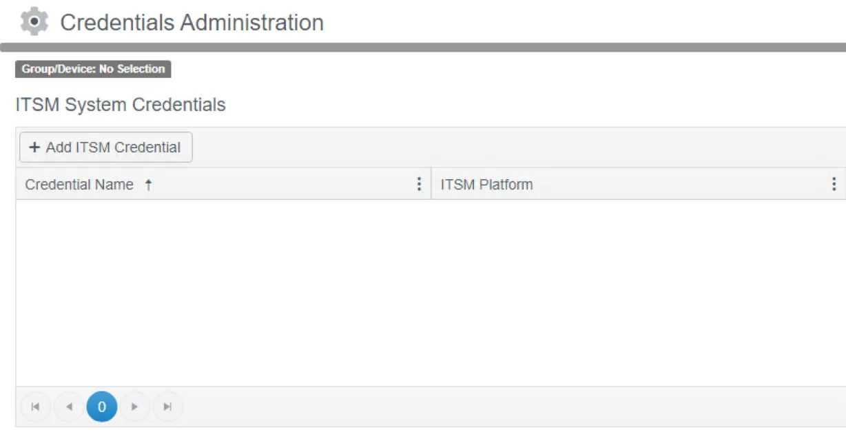

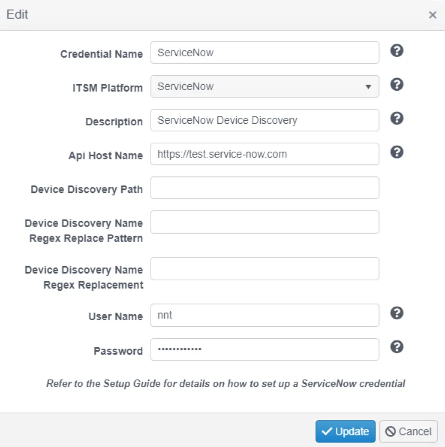

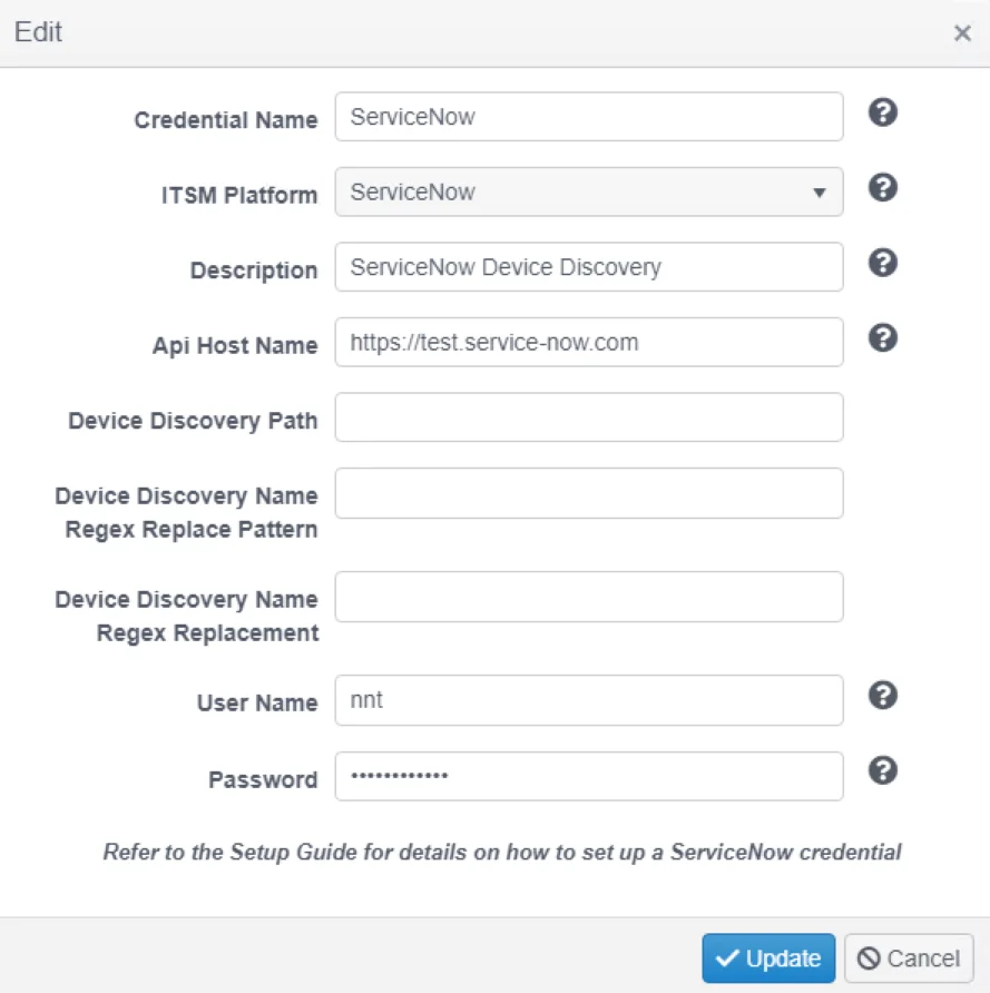

Step 1 – From the Settings menu, select Credentials, scroll to the ITSM System Credentials section and click Add ITSM Credential.
Step 2 – Select ServiceNow from the initial drop down and enter the details of the ServiceNow instance to connect to.
By default Change Tracker will look for devices in the cmdb_ci_computer table in ServiceNow's CMDB. The Device Discovery Path field can be used to specify a different table to pull devices from.
The Device Discovery Name Regex Replace Pattern field is used to define a piece of regex that can identify a pattern in device names that the user would like to not include or to replace with something else when the devices are created in Change Tracker. This can be useful when there is not an exact match between device names in the change events and device names in ServiceNow.
The Device Discovery Name Regex Replacement fields defines the value to replace the pattern defined in the field above. Leaving this empty will cause the pattern matched by the regex above to be trimmed from device names created in Change Tracker.

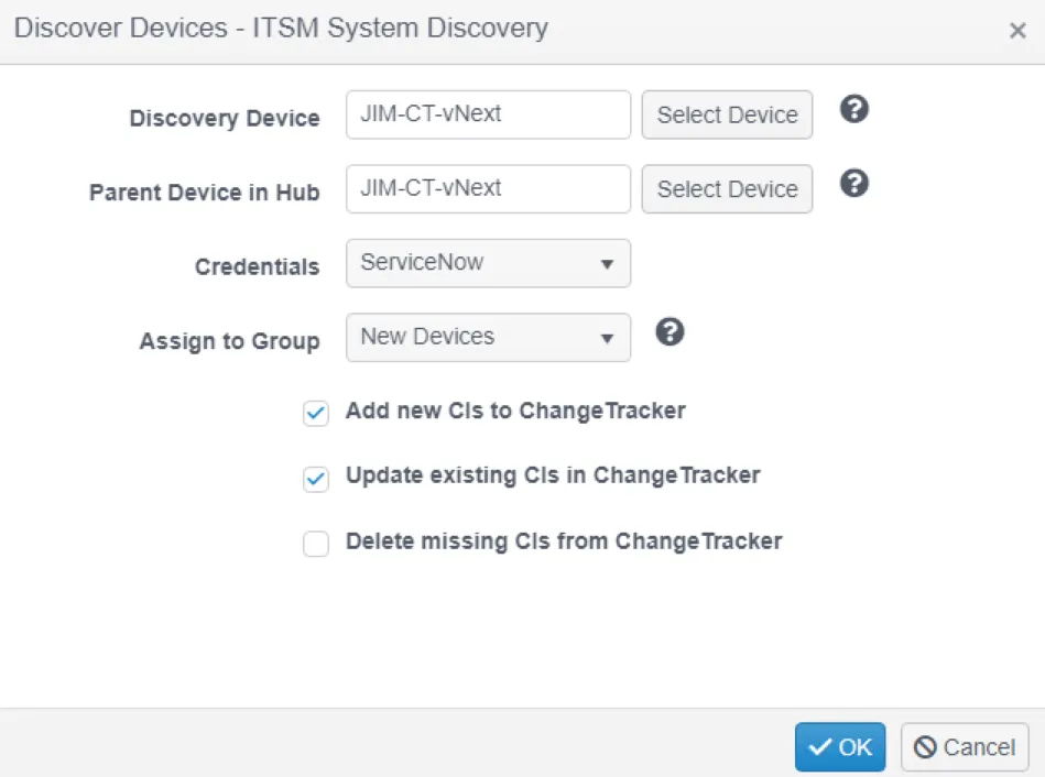

Step 3 – Select a device to act as the proxy for the calls made to ServiceNow. The agent on the same host as the Hub is often a good choice here.
Step 4 – Select the credentials created earlier.
Step 5 – Select the group to put the discovered devices into.

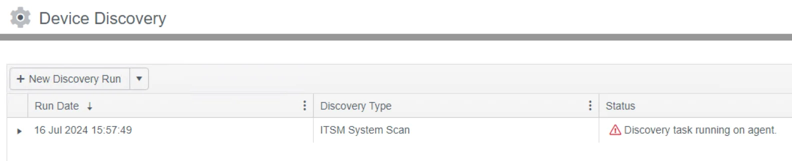

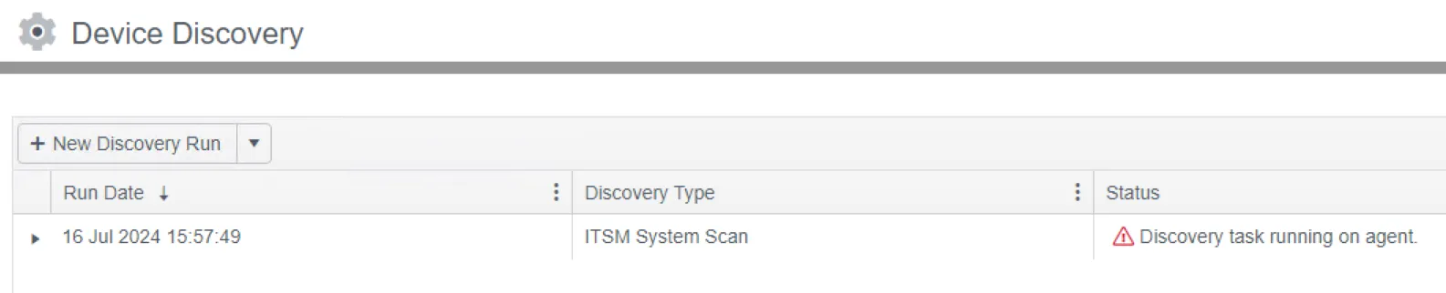

Step 6 – Click OK. A discovery task will start and create the devices.

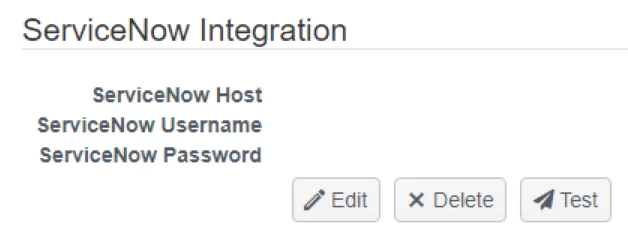

Step 1 – From the Settings menu, select System Settings and scroll to the ServiceNow Integration section. Insert the URL and credentials of the ServiceNow instance to raise incidents to. The test button will raise a test incident to prove connectivity.
