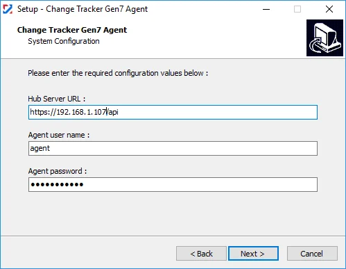

The Hub API page must be entered together with Access Credentials.
By default the Agent username is ‘agent’ with password ‘passWord121’ but these can be changed. See the Users: User Administration topic for additional information.

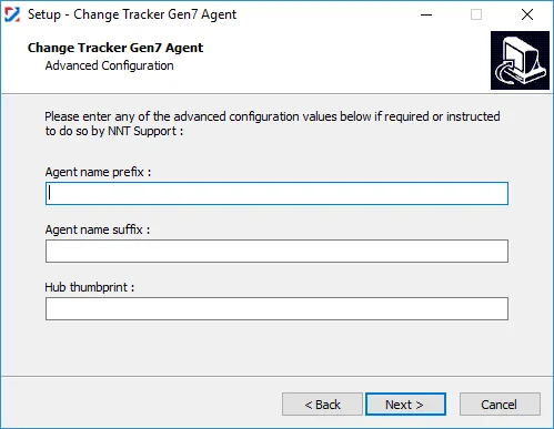

By default the Agent will register using the Name of the server but there is an opportunity to customize this during installation or post-installation via an edit of the Hub Details file. See the First Run – HubDetails.xml File topic for additional information.

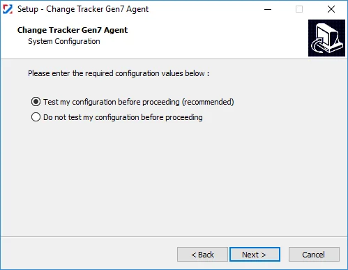

RECOMMENDED: During installation, this can also be performed on the Advanced Configuration step of the installation, and there is also an option to test agent connectivity.

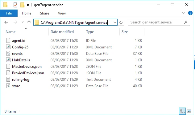

NOTE: In order to maximize performance, Gen 7 Agent operational files are located in %PROGRAMDATA%\NNT\gen7agent.service, similarly if you are ever required to provide the rolling-log.txt file to Netwrix Support this is where it is located. See the First Run – HubDetails.xml File topic for additional information on downloading the .xml file for agents.
