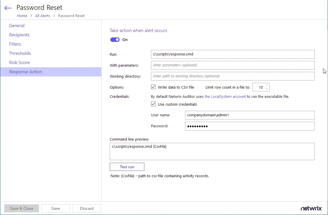

Step 1 – Turn the switch to On if you want a response action to be taken when the alert occurs.
Step 2 – In the Run field, specify the path to the executable file (.exe, .cmd, .bat; for .ps1 files see step 3 below). The file must be located on the machine where Netwrix Auditor server runs.
Step 3 – In the With parameters field, enter the parameters to be used by the executable file. Use space character as a separator.
Step 4 – To run .exe, .cmd and .bat files, you can enter the path to your command-line or batch file directly in the Run field, for example:

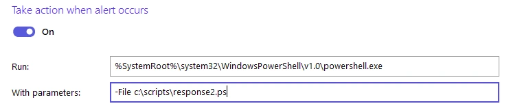

To run the .ps1 files, you will need to enter the path to powershell.exe and path to your script. For example:
  • In the Run field, enter C:\Windows\system32\WindowsPowerShell\v1.0\powershell.exe
  • In the With parameters field, enter –File <path_to_your_ps_script>
powershell_thumb_0_0

Step 5 – In the Working directory field, specify path to the working directory of the executable file on NAuditor server.
Step 6 – In the Working directory field, specify path to the working directory of the executable file on NAuditor server.
If you leave this field empty, then the path to the file specified in the Run field will be used as a working directory. As shown in the example with the .ps file, this may be the system directory. So, to avoid system directory cluttering, it is recommended not to leave the Working directory field empty but to explicitly specify the directory where your executable file is located, or a dedicated directory for that purpose. In the latter case, ensure the directory exists on Auditor server.
Step 7 – Write data to CSV file — select this option if you want Auditor to locate the activity records associated with the alert, and write the record fields and their values in a structured way to a .csv file. For each new alert being created, this option is selected by default, as well as for the predefined alerts installed with Auditor.
After the upgrade, all alerts with previously configured response action will have this option cleared.
Step 8 – Limit row count in a file to <N> — limit the number of rows (activity records) to be written to a single .csv file. Enter a value from 1 to 1000.
For details on how these options work, see the section below.
By default, the executable file will be launched under the LocalSystem account. If you want to use another account, select the Use custom credentials checkbox and specify user name and password. Make sure this account has Log on as batch job privilege.
The resulting command line including executable file name and execution parameters will appear in the Command line preview.
If you selected to Write data to CSV file, the command line will include {CsvFile_}, i.e. the file path. Alternatively, the command line will include {AlertID} and _{RecordID}_, i.e. related IDs
Step 9 – Test run — if you click this button, the executable file will be run with the specified parameters on Netwrix Auditor server. This can be helpful, for example, if you want to ensure script operability before the related alert is triggered.
