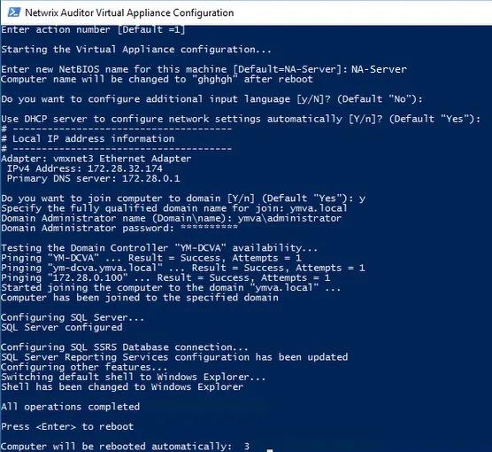

In the example below, review how the shell script configures the new VM:
appliance_script
Step 6 – When the script execution completes, you will be prompted to reboot the virtual machine for the changes to take effect.
