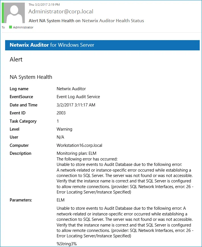

emailhealthstatusevent
If an event occurs that triggers an alert, an email notification will be sent immediately to the specified recipients.
