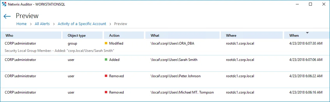

FiltersApply a set of filters to narrow events that trigger a new alert. Alerts use the same interface and logic as search. - Filter — Select general type of filter (e.g., "Who", "Data Source", "Monitoring plan", etc.) - Operator — Configure match types for selected filter (e.g., "Equals", "Does not contain", etc.) - Value — Specify filter value. See the View and Search Collected Data topic for additional information on how to create and modify filters. The Filters section contains required fields highlighted with red. Once you completed all filters, click Preview on the right pane to see search-based list of events that will trigger your alert. preview_thumb_0_0
