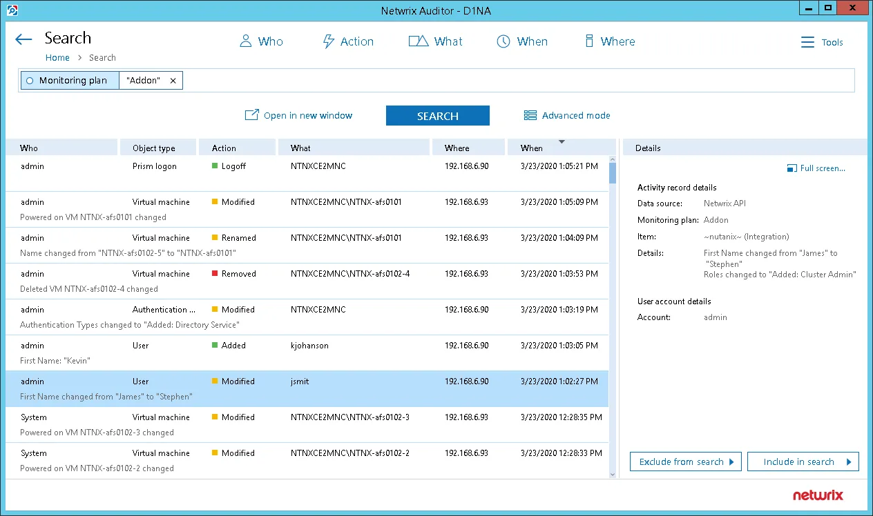

To work with data collected by the add-on, you can do the following in Auditor:
  • Search for required data. For that, start Auditor client and navigate to Search. After specifying the criteria you need, click Search. You will get a list of activity records with detailed information on who did what in the reported time period.
You might want to apply a filter to narrow down your search results to the NetwrixAPI data source only.
screen_results
