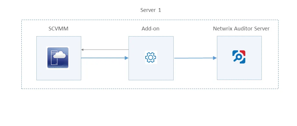

  1. Add-on running on the same machine as SCVMM server (with Management Console):
deployment_1

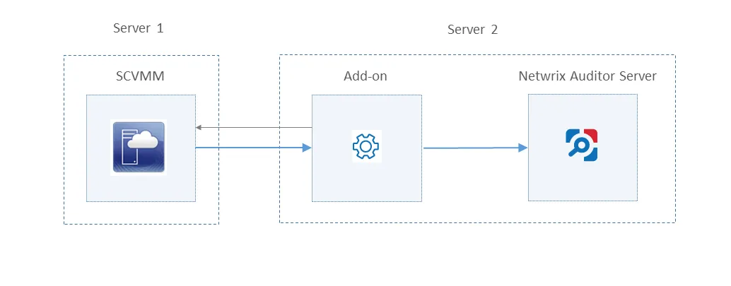

  1. Add-on and SCVMM server (with Management Console) running on different machines:
deployment_2
In this scenario, the account used to access SCVMM server must be a member of the Remote Management Users local group on the SCVMM server.

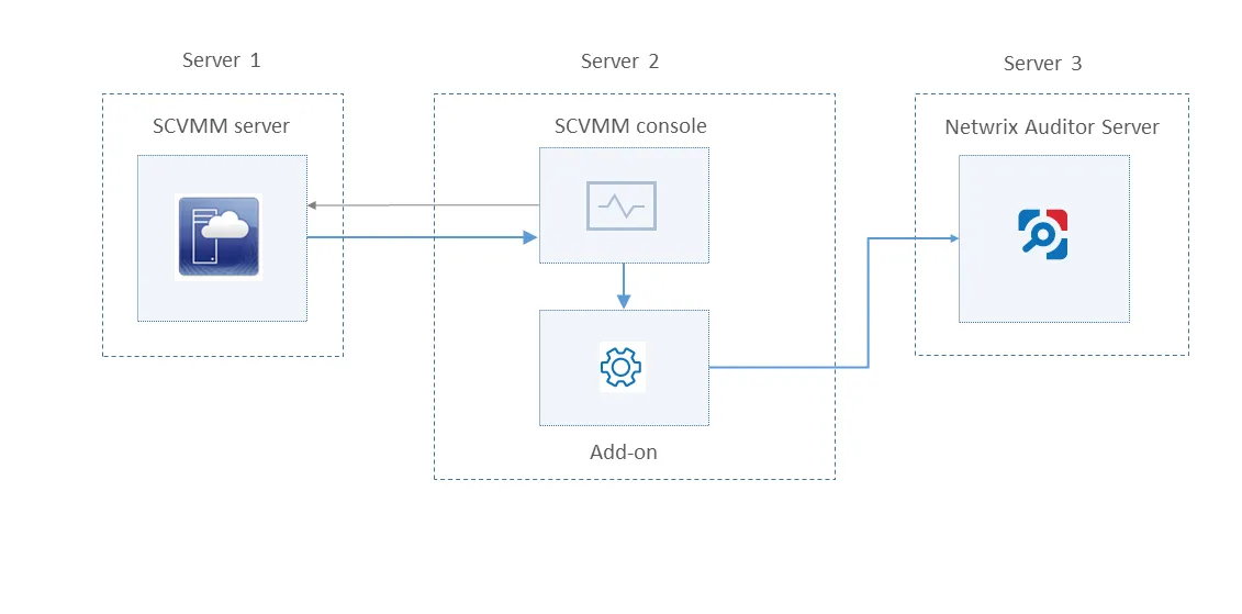

  1. Add-on running on the same machine as SCVMM Management Console; SCVMM server running on the remote machine:
deployment_3
In this scenario, ensure to specify SCVMM server address in the DataCollectionServer parameter (not the machine where SCVMM console runs) in the settings.xml configuration file. See the Add-On Parameterstopic for additional information.
