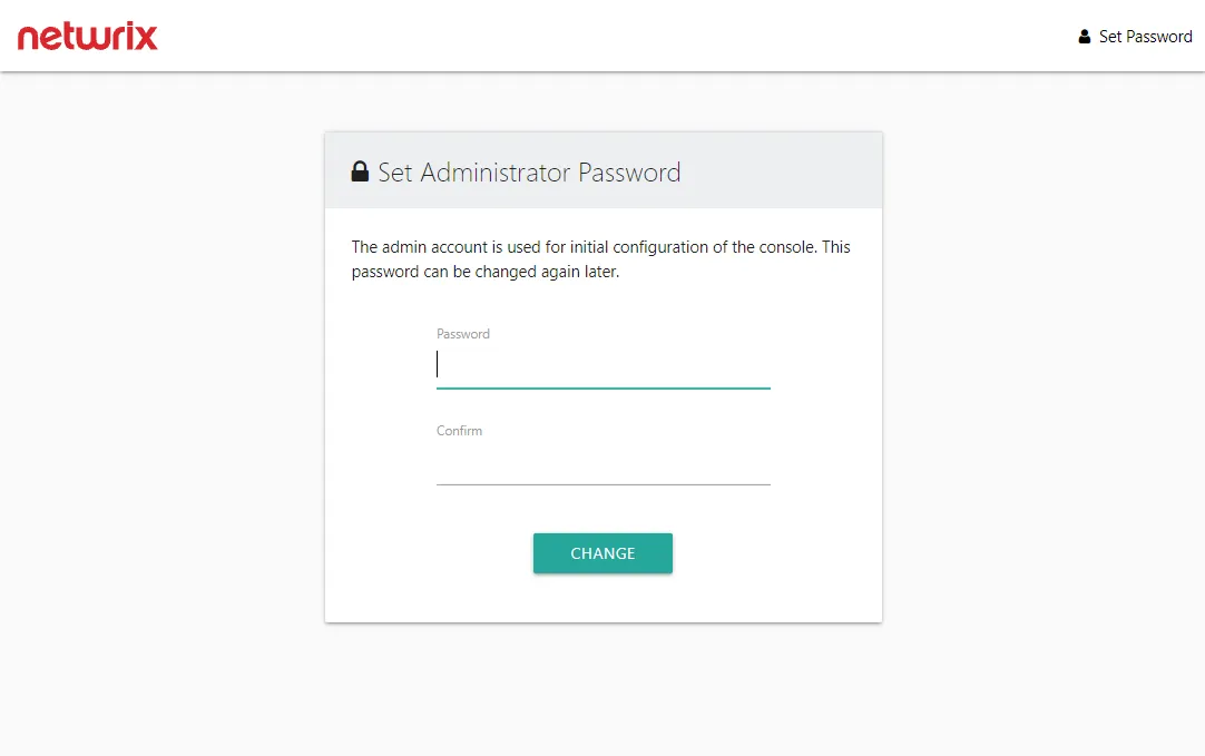

The Access Reviews application is installed with a Builtin Administrator account; "admin" is the User Name. You will be prompted to set the account's password. It must be eight or more characters long. After setting the password, you will need to login with the "admin" account.

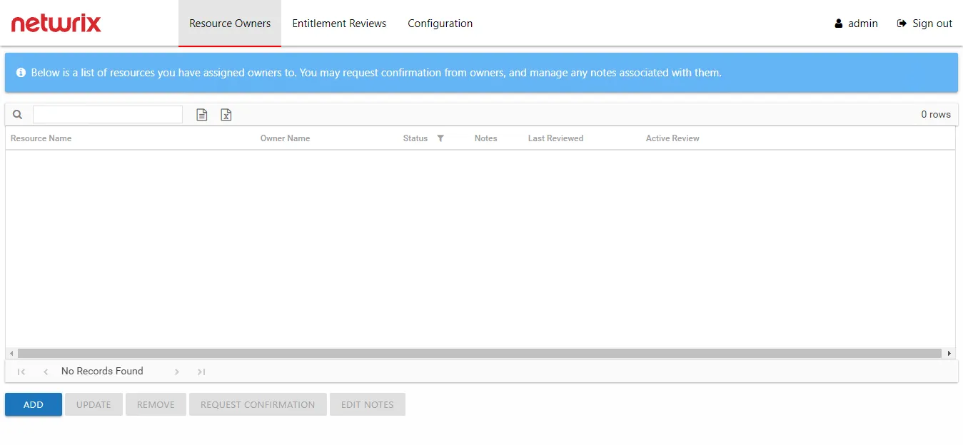

The Resource Owners interface opens. The first thing that should be done is to configure console access for domain users and configure notification settings. Select the Configuration tab. See the Console Access Page and Notifications Page topics for additional information.
