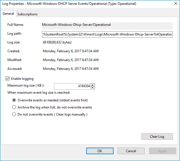

  1. On the DHCP server, navigate to Event Viewer.
  2. Navigate to Event Viewer tree → Applications and Services Logs → Microsoft → Windows and expand the DHCP-Server node.
  3. Right-click the Operational log and select Properties.
    manual_config_dhcp_log
  4. Make sure the Enable logging option is selected.
  5. Set Maximum log size to 4 GB.
  6. Set the retention method to Overwrite events as needed (oldest events first). Click OK to save the settings and close the dialog.
