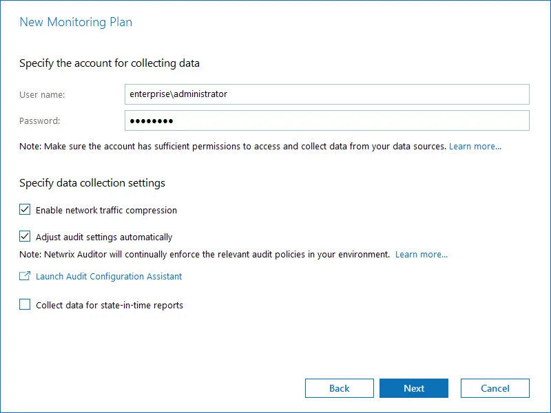

  • When creating a new monitoring plan, at the first step of the wizard select the Adjust audit settings automatically option. See the Create a New Monitoring Plan topic for additional information.
mp_wizard_step1_ad

  • For both new and existing monitoring plans, you can click Launch Audit Configuration Assistant (in the wizard step or in the plan settings, respectively) to launch a special tool that can detect current infrastructure settings and adjust them as needed for monitoring. See the Audit Configuration Assistant topic for additional information.
