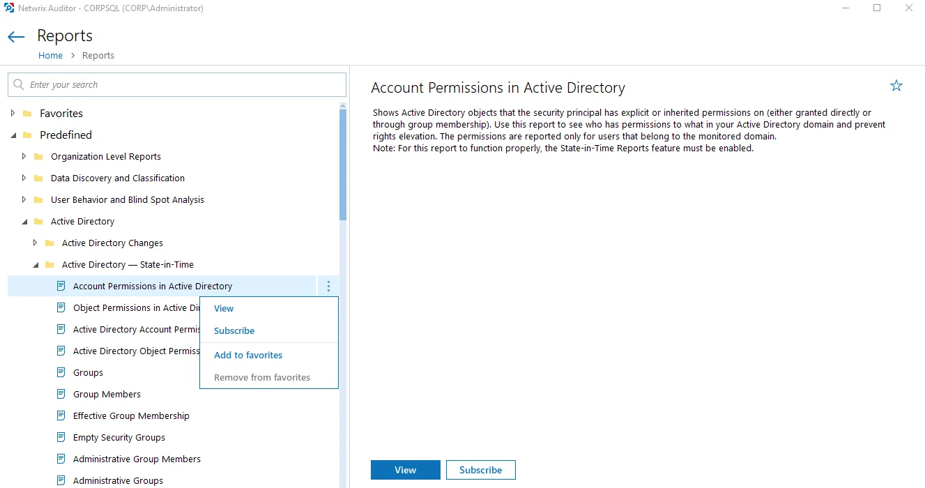

View Report and Add to Favorites
Follow the steps to view a report and add it to the list of Favorites.
Step 1 – On the main Auditor page, click the Reports tile in the upper left corner.
Step 2 – Open a report you are interested in; for example, Account Permissions in Active Directory:
scenario_reports_1
Step 3 – Click the report menu (three dots) to the right and select Add to favorites. (Alternatively, click the star icon in the upper right corner of the report description.)
The report is added to the Favorite reports section on the home page and you can run it instantly.
scenario_reports_2

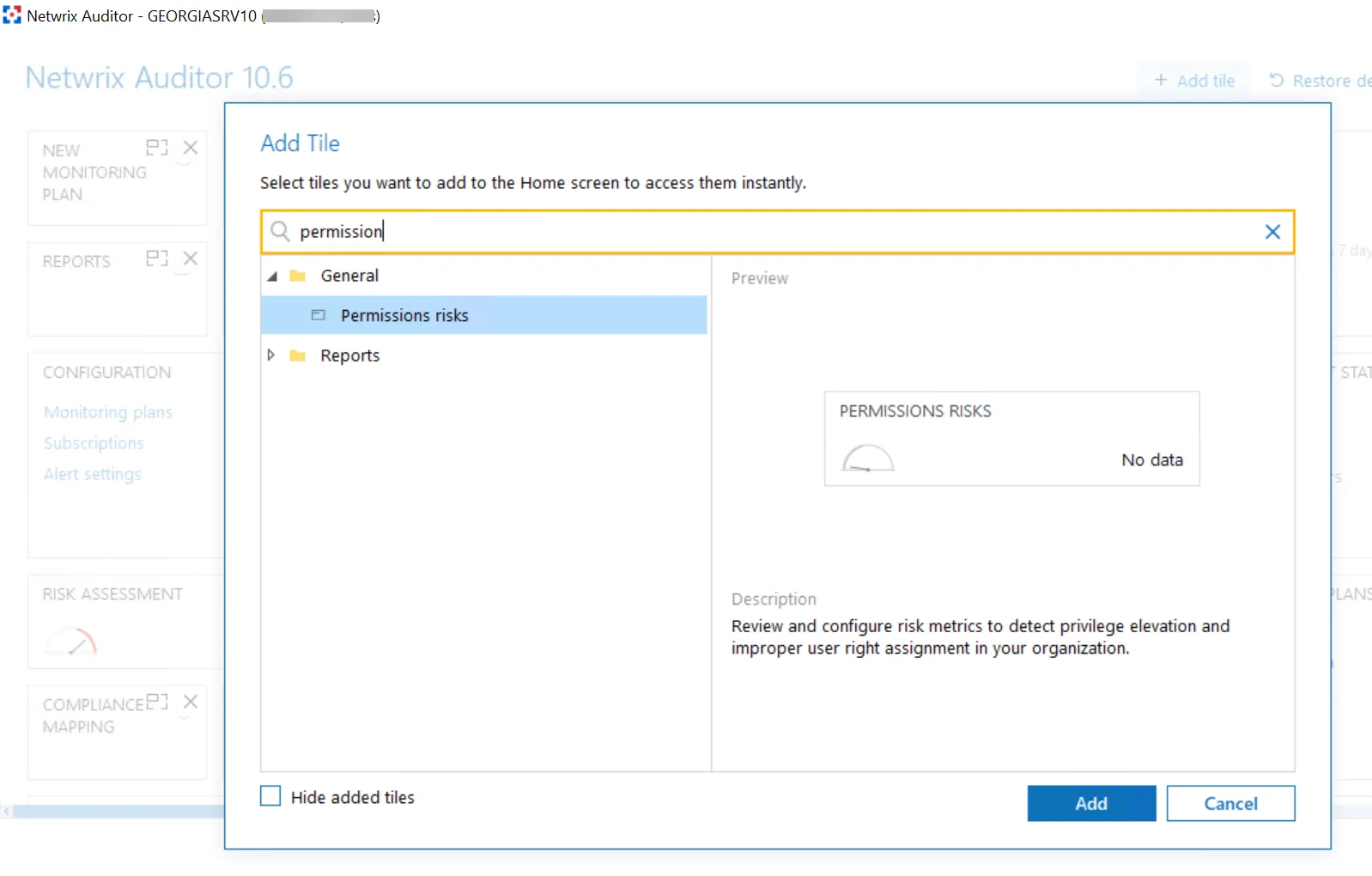

Review and Pin Risks
Follow the steps to review risks and pin important ones to the Home Screen.
Step 1 – On the main Auditor page, click the Risk Assessment tile.
Step 2 – Review the Risk Assessment Overview dashbord and select the risk you are interested in, such as "User Accounts with administrative permissions". See the IT Risk Assessment Overview topic for additional information.
Step 3 – To access this risk quickly, pin it to the home page, as follows:
  1. On the main product page, click Customize.
  2. Click Add tile.
  3. Search the group of risks you want to pin to the home page (in this case, the "Permissions" risks group):
    scenario_risks
Step 4 – Click Add.
The selected risks group is added to the home screen.

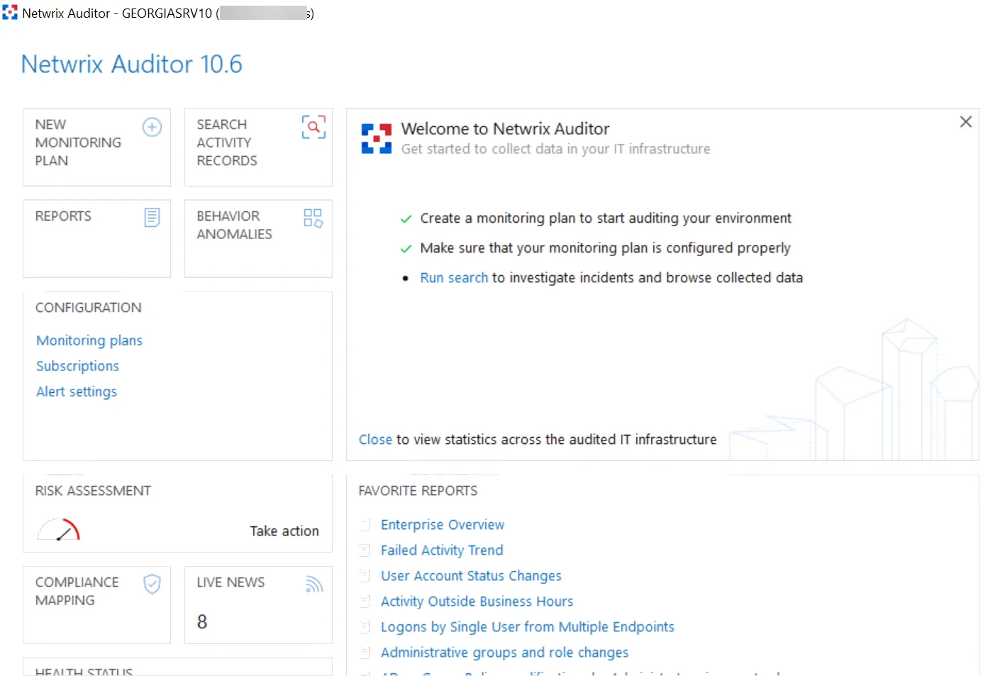

What is Next?
Personalize the home page of the product depending on your business needs. Review the customization settings and collect only required tiles for quick access on the Auditor home page. See the Customize Home Screen topic for additional information.
