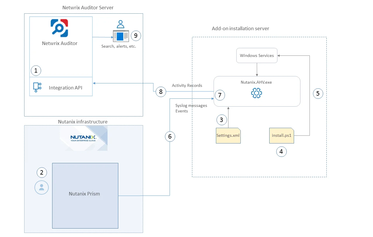

How it works
The add-on is implemented as a Syslog service that collects activity data from Nutanix infrastructure and sends it to Netwrix Auditor using the Integration API.
On a high level, the solution works as follows:
An IT administrator configures the Integration API settings to enable data collection and storage to Netwrix database for further reporting, search, etc.
It is recommended to create a dedicated monitoring plan in Netwrix Auditor and add a dedicated item of Integration type to it — then you will be able to filter data in reports and search results by monitoring plan/item name.
On Nutanix side, the IT administrator prepares a dedicated user account for accessing Nutanix Prism Central/Element and configures Syslog server (IP, port, etc.).
The administrator opens the Settings.xml configuration file and specifies the necessary parameters for add-on operation, Netwrix Auditor settings, etc. The add-on will operate as a Syslog listener for Nutanix server.
The administrator runs the Netwrix.IntegrationConfiguration.exe file and provides credentials to connect to Prism Central server.
The administrator selects the deployment scenario and runs the install.ps1 PowerShell script file to deploy and configure the add-on components on the target server.
In particular, the script deploys and starts Netwrix Auditor Add-on for Nutanix AHV Windows Service— this is the main add-on component, responsible for audit data collection and forwarding.
The add-on starts collecting and forwarding activity data from Nutanix Prism server: it listens to the specified UDP port and captures designated Syslog event messages and also collects activity data using Nutanix REST API.
Syslog event data communication is performed using UDP version of Syslog protocol. See the Monitoring Scope topic for additional information on the default list of events supported out-of-the box.
- The add-on processes the incoming Syslog messages and activity data collected using Nutanix REST API into NAuditor -compatible format (Activity Records). Each Activity Record contains the Who-What-When-Where-Action information (that is, initiator's account, time, action, and other details).
- Using the Integration API, the add-on sends the activity records to Auditor Server that writes them to the Audit Database and Long-Term Archive. Data is sent periodically, by default every second.
See the Integration API topic for additional information on the Activity Record structure and capabilities of the Integration API.
