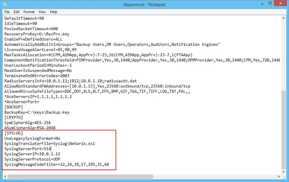

Step 2 – On the CyberArk server, locate the %Program Files (x86)%\PrivateArk\Server\Conf folder and open the dbparam.ini file for editing.
Step 3 – Go to the [SYSLOG] section and configure the following parameters:
  • SyslogTranslatorFile – relative path to Netwrix.xsl file. You will need to create this file manually and copy the content of SyslogTranslator.sample.xsl file into it. This sample file is provided by CyberArk. By default, it is located in the %Program Files (x86) %\PrivateArk\Server\Syslog folder.
    Place the Netwrix.xsl file there, too, so that default relative path should be \Server\Syslog.
  • SyslogServerPort – communication port of the syslog server (i.e. add-on installation server). Default is 514. Note that if you are using Netwrix Auditor for Network Devices, this port may be already in use, and you should provide another one.
  • SyslogServerIP - IP address of the add-on installation server.
  • SyslogServerProtocol – communication protocol for data transfer between CyberArk system and the add-on. Specify UDP protocol.
  • SyslogMessageCodeFilter - IDs of events to forward. The add-on will only collect and process events you specify in this parameter. For the full list of supported events, see Monitored Events. Use comma as a separator.
dbparamfile
Step 4 – Save the dbparam.ini file.

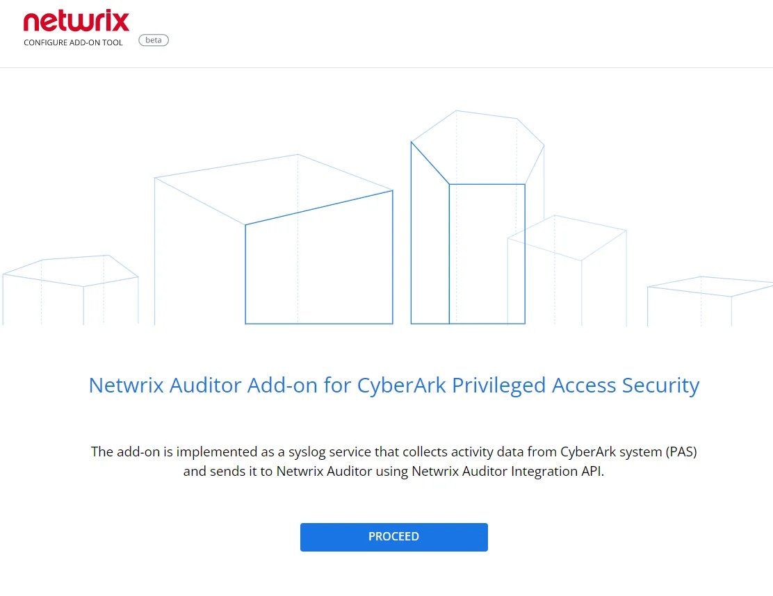

The configuration wizard opens in the default web browser:
ConfigurationWizard
Click Proceed and complete the following fields:
