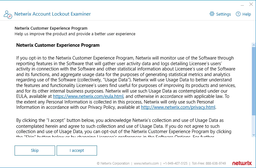

- If you wish, select to participate in Netwrix Customer Experience Improvement program. You can later change your preference using the product settings (see the next section for details).

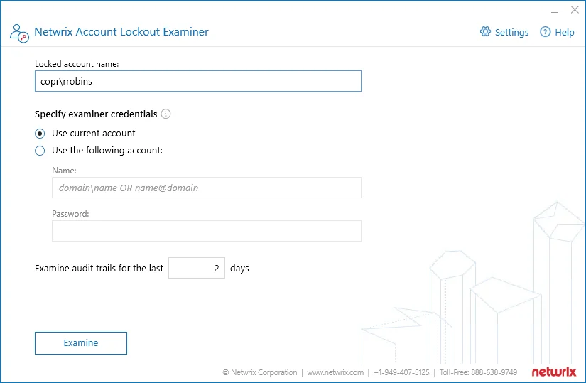

- In the main window, supply the name of the account that was locked out.
- Specify examiner credentials – the user account that will be used to run the examination, access domain controllers, and so on. The account must be a member of the Domain Admins group.
- Click Examine.

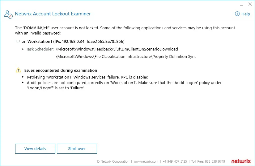

Once the examination completes, you will be presented with a list of reasons why the account you supplied is being locked out.

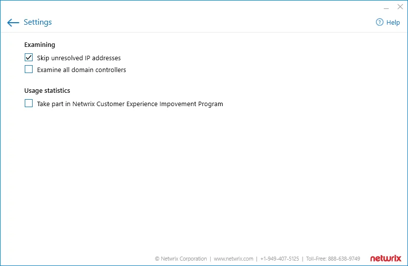

Modifying product settings
After you click Settings in the main window, you can apply the following options:
| Option | Description | Default |
| Examining | ||
| Skip unresolved IP addresses | For safety reasons, Netwrix Account Lockout Examiner by default does not connect to the unknown and potentially dangerous IP addresses. See this Knowledge Base article for more information. | Enabled |
| Examine all domain controllers | Select this option if you want to examine all domain controllers to detect potential lockout reason. | Disabled |
| Usage statistics | ||
| Take part in Netwrix Customer Experience Improvement program | Select this option to participate in the program. See this Knowledge Base article for more information on the program. |

| Symptom | Cause | Solution |
| In the environments with root/child domains, you may receive the “Could not query ComputerName. Access is denied.” error. | The account used to run Netwrix Account Lockout Examiner is not a member of the local Administrators group on the workstations in both root and child domains. Administrative rights are required to access the Security Event logs on these workstations. | Make sure this account is included in the local Administrators group. |
| Issues encountered during examination section is shown in the examination results. | Most probably this means that Netwrix Account Lockout Examiner cannot reach some of the data sources it needs. | - Check that you have configured the audit settings in the target domain as described in Required audit settings section. - Check that network connectivity between the Account Lockout Examiner machine and the domain controllers in your domain works properly. |
