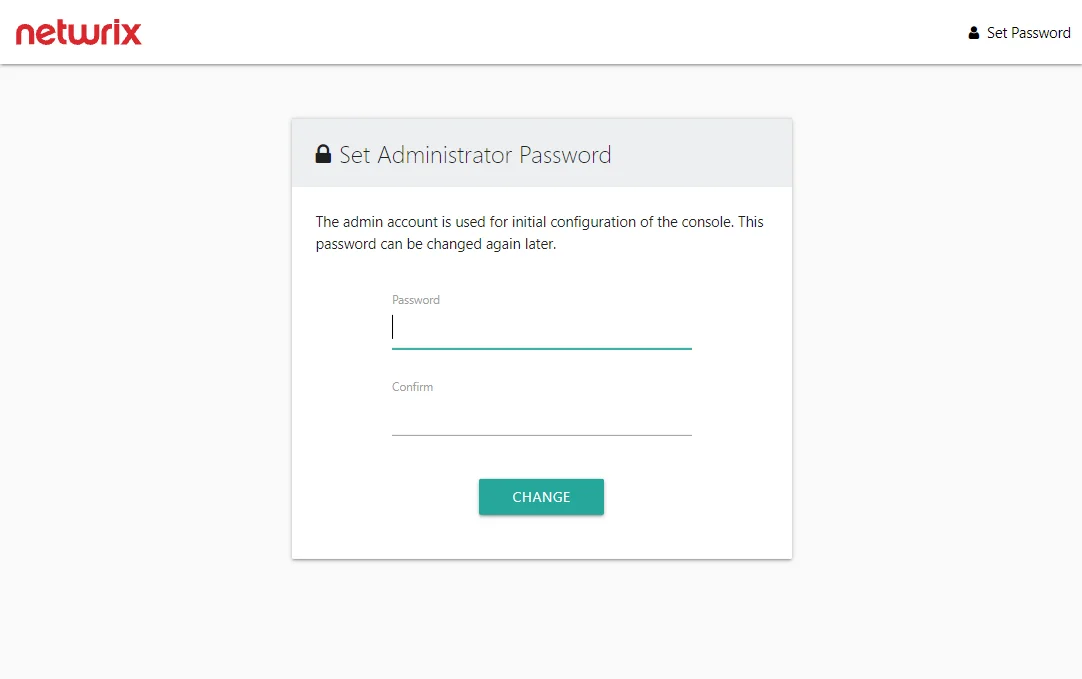

Set Builtin Administrator Password page
The Access Reviews application is installed with a Builtin Administrator account; "admin" is the User Name. You will be prompted to set the account's password. It must be eight or more characters long. After setting the password, you will need to login with the "admin" account.
Using the Configuration interface, the Builtin Administrator account can be disabled once a domain account has been granted the Administrator role. You can also change the password for the Builtin Administrator account. See the Modify the Builtin Administrator Account topic for additional information.

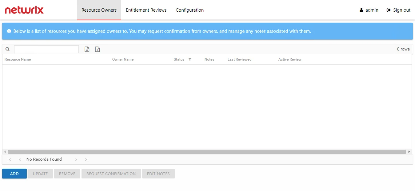

firstlaunchlandingpage
The Resource Owners interface opens. The first thing that should be done is to configure console access for domain users and configure notification settings. Select the Configuration tab. See the Console Access Page and Notifications Page topics for additional information.
The interfaces available to console users are controlled by the role assigned. Owners do not need to be assigned console access. See the URL & Login topic for information on how users will log in and where they are directed after login.
