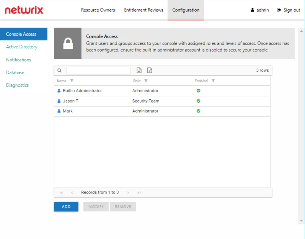

Console access is configured through the Configuration > Console Access page. Adding users to the Access Reviews Console requires the Active Directory service account to be configured.
There are two levels of access, or roles, which can be granted to domain users or groups:
Administrator – Role allows access to all interfaces including the Configuration interface
Security Team – Role allows access to all interfaces except for the Configuration interface
- In the Entitlement Reviews interface, this role can only view reviews that the logged in user has created.
- Access can be limited by resource types (File System, SharePoint, or Active Directory)
CAUTION: Before disabling the Builtin Administrator account, it is necessary to first assign at least one domain user account to the Administrator role. Login with another Administrator account to disable the Builtin Administrator. Failure to do this could result in being locked-out of the Configuration interface. As an alternative to disabling this account, the password can be changed. See the Modify the Builtin Administrator Account topic for additional information.

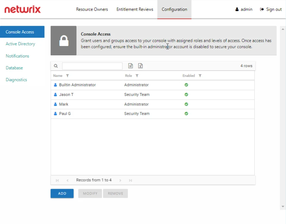

Step 1 – In the Configuration interface on the Console Access page, click Add. The Console Access wizard opens.

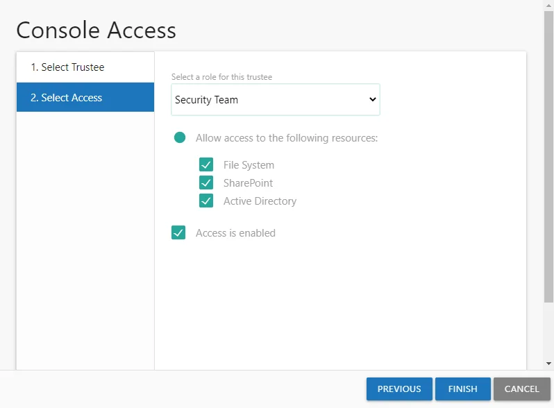

Step 2 – On the Select Trustee page, enter the following information and click Next:
- Domain — If the Access Reviews Console has been configured for multiple domains, use the drop-down menu to select the desired domain
- Search — Begin typing the sAMAccountName or display name and the field will auto-populate options from Active Directory sAMAccountName
Step 3 – On the Select Access page, enter the following information and click Finish:
Select a role for this trustee – Select a role from the drop down list:
- Unlimited Access — The Administrator role grants unlimited access
- Limited Access — All other roles can be granted limited access
Allow access to the following resource — When enabled, users can be limited to only having visibility into data for the selected types of resources. Check the boxes for the type of resource data to be made available to this user.
Access is enabled – A user's account must be enabled in order to log into the console. Unchecking this option allows you to configure access to be granted at a future time.
Step 4 – The new user displays in the list on the Console Access page. Repeat these steps for each trustee to be granted console access.
Once the first user with the role of Administrator has been added, the Builtin Administrator account can be disabled by that user. See the Modify the Builtin Administrator Account topic for additional information.

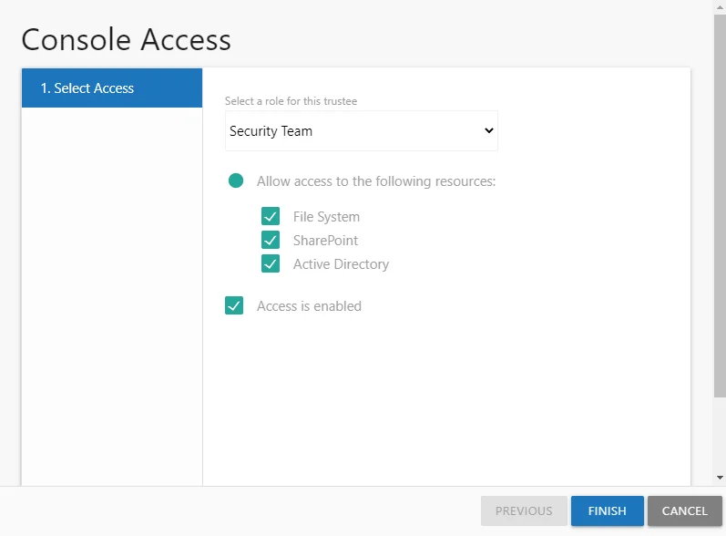

Step 1 – In the Configuration interface on the Console Access page, select the user to be modified and click Modify. The Console Access wizard opens to the Select Access page.
Step 2 – Modify the desired settings and click Finish:
Allow access to the following servers — When enabled, users can be limited to only having visibility into data for specific servers. Begin typing server names and the field will auto-populate with known servers from scanned data. A resource type appears in parentheses after the host name for quick reference.

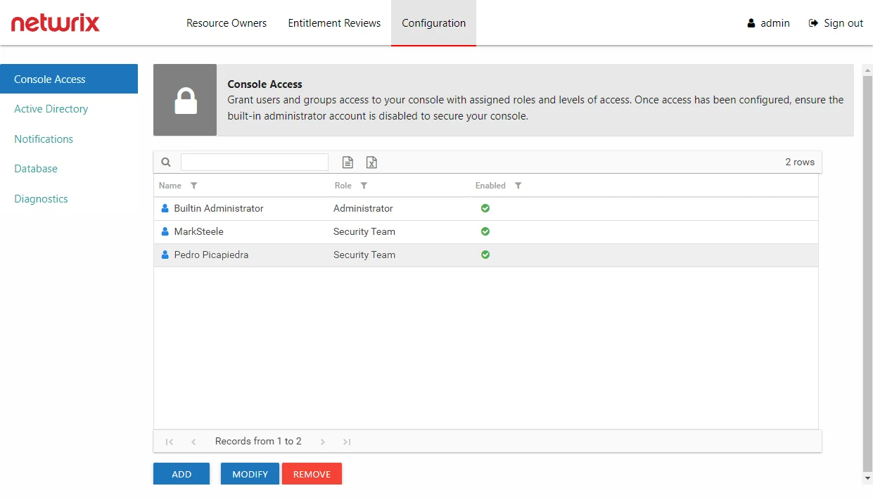

Any modifications to the user’s role are visible in the list on the Console Access page.

Step 1 – In the Configuration interface on the Console Access page, select the user.
Step 2 – Click Remove.
The user is removed from the list on the Console Access page.
The Builtin Administrator account can be disabled or its password can be changed. Follow the steps to modify this account.
Step 1 – In the Configuration interface on the Console Access page, select the Builtin Administrator account and click Modify. The Builtin Administrator window opens.
Step 2 – Modify the account as desired and click OK:
- Access is enabled — Indicates whether the account can be used to login
- Change Password — Allows you to change the password for this Builtin Administrator account. Check the box and enter the new password in both entry fields. The password must be eight or more characters long.
The modifications to the Builtin Administrator are processed.
