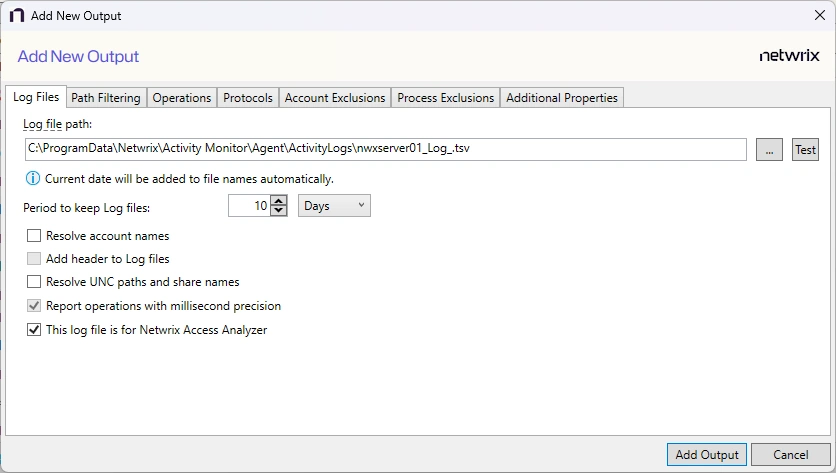

Add File Output
Follow the steps to add a File output.
Step 1 – On the Monitored Hosts & Services tab, select the desired host and click Add Output.
Step 2 – Select File from the drop-down menu. The Add New Output window opens.
addnewoutputfile
Step 3 – Configure the tab(s) as desired.
Step 4 – Click Add Output to save your settings. The Add New Output window closes.

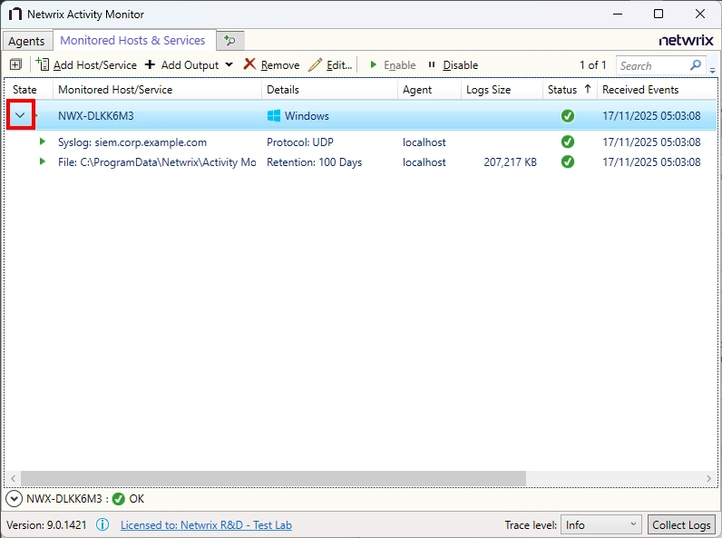

The new output displays in the table. Click the Edit button to open the Output properties window to modify these settings. See the Output Types topic for additional information.

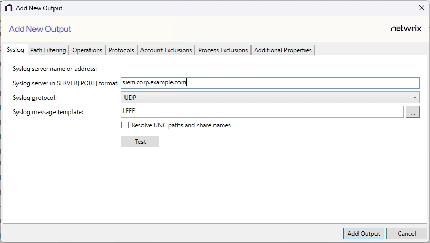

Add Syslog Output
Follow the steps to add a Syslog output.
Step 2 – Select Syslog from the drop-down menu. The Add New Output window opens.
addnewoutputsyslog
