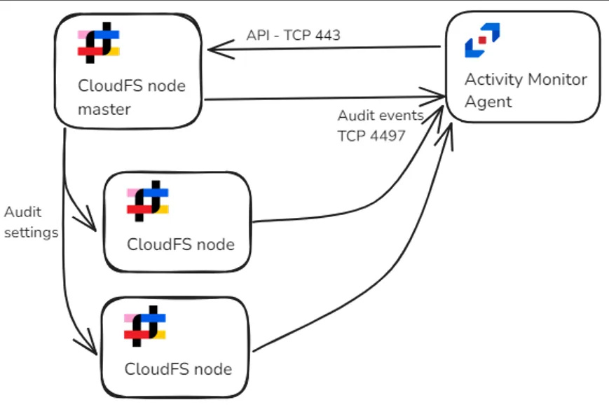

Auditing must be enabled on the master Panzura node and optionally overridden on the subordinate nodes to support different deployment scenarios depending on the expected load and network latency. A single agent monitors several Panzura nodes.
panzurasingleagntmonitor

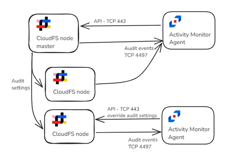

Audit events are distributed between two agents. Audit settings are overridden on one Panzura node.
auditeventstwoagnt_panzura
