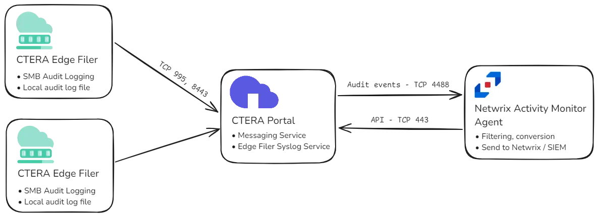

The Netwrix Activity Monitor can be configured to monitor file system activity on CTERA Edge Filer appliances.
The monitoring process relies on the SMB auditing feature of the CTERA Edge Filer. A local audit log file is generated by each Edge Filer and audit events from these files are collected by the CTERA Portal. The CTERA Portal forwards the events from the Edge Filers to the Activity Monitor Agent through the Messaging and Syslog services.
Monitoring Process -CTERA Portal
