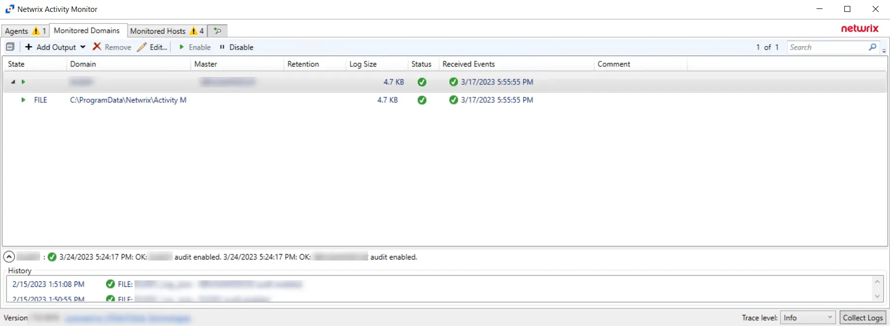

Step 1 – In the Activity Monitor, click on the Monitored Domains tab.
Step 2 – Select a domain and click Edit.

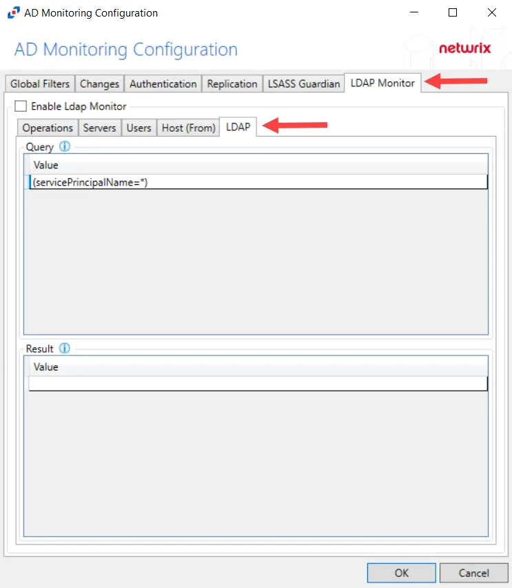

Step 3 – Select the LDAP Monitor tab.
Step 4 – Select the LDAP tab.
Step 5 – In the “Query” section, double-click the blank line below the last filled in line.
Step 6 – Paste the string copied from Threat Manager and press Enter.
LDAP monitoring has been configured for Threat Manager.
