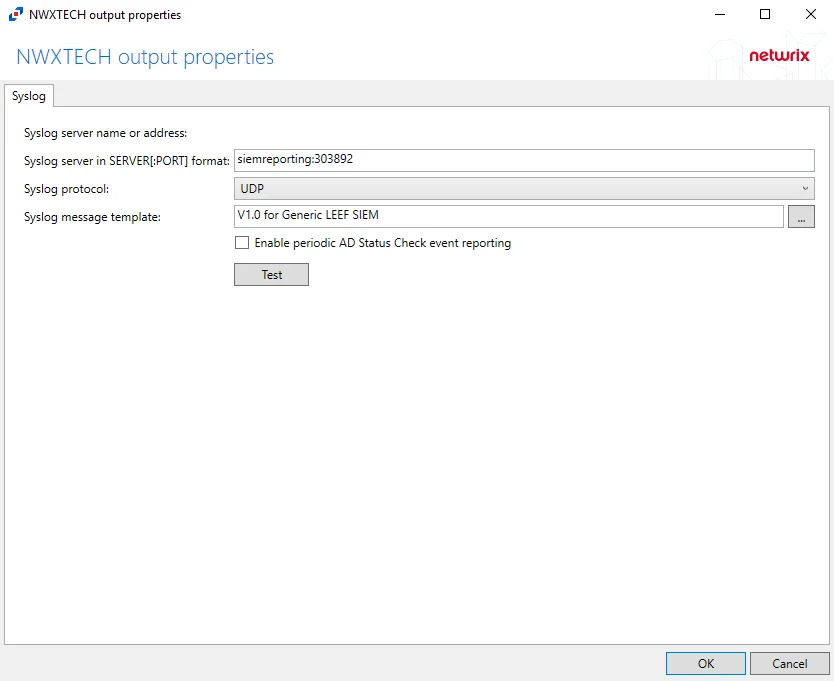

For Active Directory Domains
The tab contains the following settings:
syslogactivedirectory
  • Syslog server in SERVER:PORT format – Server name of the SIEM server and the communication port being used between the applications. The format must be SERVER:PORT, e.g. newyorksrv20:10000.
    • The server name can be short name, fully qualified name (FQDN), or IP Address, as long as the organization’s environment can resolve the name format used.
  • Syslog protocol – Identifies which protocol is used for the Event stream. The dropdown menu includes: UDP, TCP, and TLS.
  • Message framing – The TCP and TLS Syslog protocols require Message framing to be set. The dropdown menu includes: LS (ASCII 10) delimiter, CR (ASCII 13) delimiter, CRLF (ASCII 13, 10) delimiter, NUL (ASCII 0) delimiter, and Octet Count (RFC 5425).
  • Syslog message template – Template that controls what data is sent in the event stream. The ellipsis (…) button opens the Syslog Message Template window. See the Message Template Window topic for additional information.
  • Enable periodic AD Status Check event reporting – Indicates periodic AD Status Check event reporting. The agent will send out status messages every five minutes to verify whether the connection is still active.
The Test button sends a test message to the Syslog server to check the connection. A green check mark or red x will indicate whether the test message has been sent or failed to send. Test messages vary by Syslog protocol:
  • UDP protocol – Sends a test message and doesn't verify connection
  • TCP protocol – Sends test message and verifies connection
  • TLS protocol – Sends test message and verifies connection and shows an error if TLS handshake fails
Click OK to commit the modifications. Click Cancel to discard the modifications. The output Properties window closes.

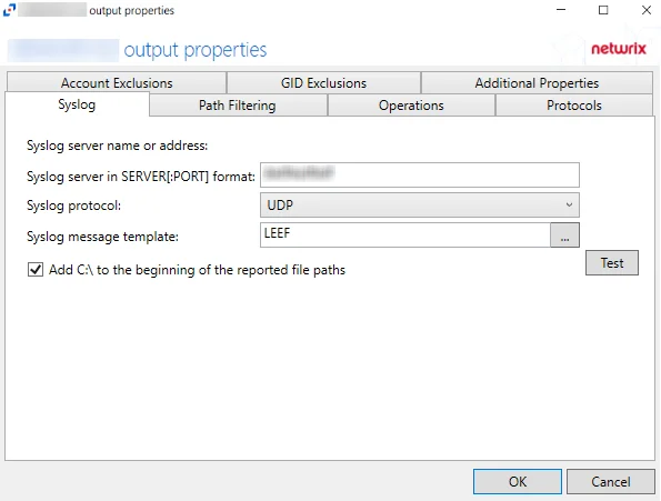

For Linux Hosts
sysloglinux
    • The default port for Netwrix Threat Manager is 10001.
  • Syslog protocol – Identifies which protocol to use for the Event stream. The dropdown menu includes: UDP, TCP, and TLS.
    • UDP is the only protocol that Threat Manager supports.
  • Add C:\ to the beginning of the reported file paths – Indicates a Windows-style drive path (C:) is added to the beginning of the NAS file paths in the activity data stream, e.g. C:\Folder\file.txt

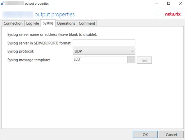

For Microsoft Entra ID, SharePoint Online, and SQL Server Hosts
syslogentraid

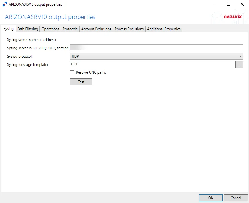

For NAS Device Hosts
syslognas
    • The default port for Netwrix Threat Manager is 10000.
  • Resolve UNC paths

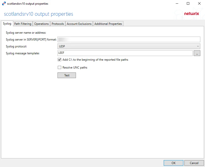

For Windows File Server Hosts
syslogwindows
    • UPD is the only protocol supported for Threat Manager.
  • Resolve UNC paths
