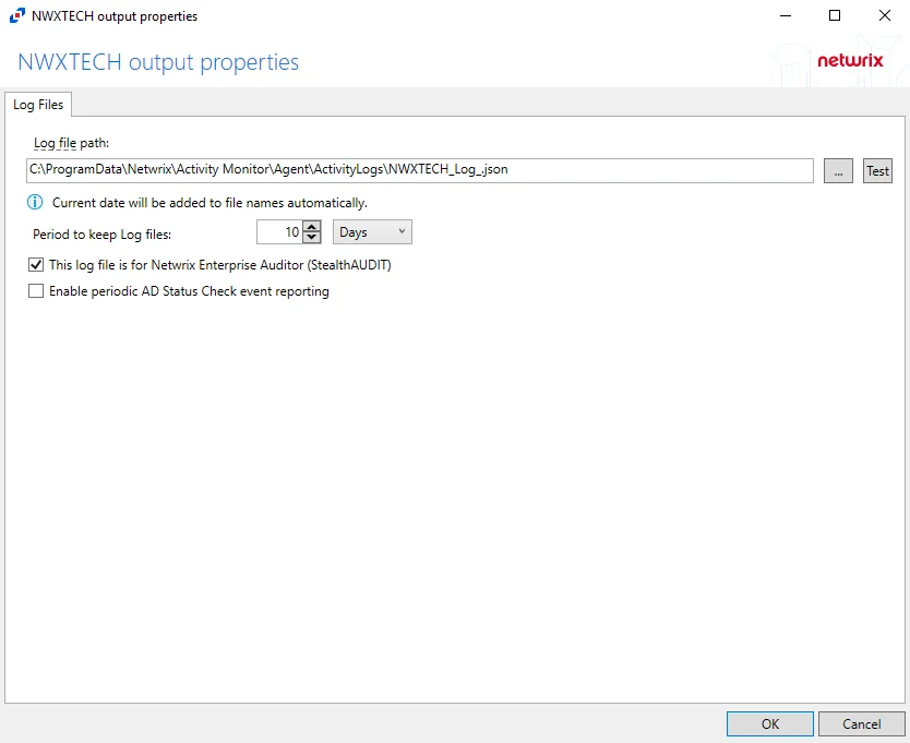

For Active Directory Domains
The tab contains the following settings:
logfilesactivedirectory
  • Log file path – Identifies the full path of the activity log files on the activity agent server. The date timestamp is appended to the file name automatically.
  • Period to keep Log files – Activity logs are deleted after the number of days entered. The default is 10 days. The Active Directory activity log settings also affect log size by controlling the information recorded per event.
    This setting effects activity log retention whether the archiving feature is enabled.
    info
    Keep a minimum of 10 days of activity logs. Raw activity logs should be retained to meet an organization’s audit requirements.
  • This log file is for Netwrix Enterprise Auditor (StealthAUDIT) – Indicates whether Netwrix Enterprise Auditor collect the data from this configured output
    While the Activity Monitor can have multiple configurations per host, Netwrix Enterprise Auditor can only read one of them.
  • Enable periodic AD Status Check event reporting – Indicates periodic AD Status Check event reporting is enabled, which means the agent will send out status messages every five minutes to verify whether the connection is still active.
Click OK to commit the modifications. Click Cancel to discard the modifications. The output Properties window closes.

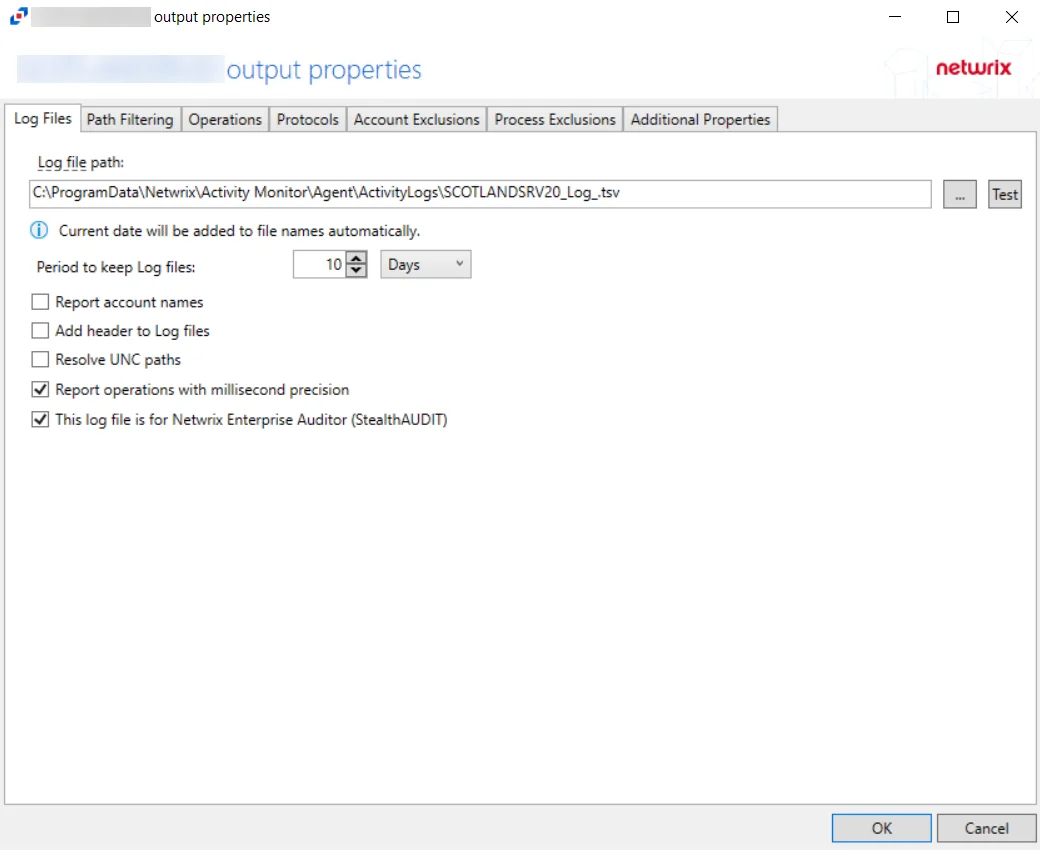

For File Server and NAS Device Hosts
Log File Tab - Windows File servers and NAS devices hosts
    info
    • For integration with Netwrix Enterprise Auditor File System Solution, this value must be higher than the number of days between the 0.Collection > 1-FSAC System Scans Job scans. See the Netwrix Enterprise Auditor Documentation for additional information.
    • For integration with Netwrix Threat Prevention NAS monitoring, this setting only controls the log retention period for NAS devices, as Netwrix Threat Prevention doesn't read Windows file server activity from Activity Monitor.
  • Report account names – Indicates if an Account Name column is added in the activity log files
  • Add header to Log files – Indicates if headers are added in the activity log files
    This is needed to feed data into Splunk in a Syslog output. However, Netwrix Enterprise Auditor doesn't support log files with headers. Therefore, don't select this option for a File output designed for Netwrix Enterprise Auditor.
  • Report UNC paths – Indicates if a UNC Path column and a Rename UNC Path column are added in the activity log files. This option corresponds to the REPORT_UNC_PATH parameter in the INI file. When the option is enabled, the added columns are populated when a file is accessed remotely through the UNC Path. If a file is accessed locally, these columns are empty.
    • The UNC Path is in the following format:
      • For CIFS activity – The path is in \\[HOST]\[SHARE]\[PATH] format, e.g. \\ExampleHost\TestShare\DocTeam\Temp.txt
      • For NFS activity – The path is in [HOST]:/[VOLUME]/[PATH] format, e.g. ExampleHost:/ExampleVolume/DocTeam/Temp.txt
    When this option is selected, a warning message might be displayed.
  • Report operations with millisecond precision – Indicates the timestamps of events being recorded in the activity log file has been changed for better ordering of events if multiple events occur within the same second

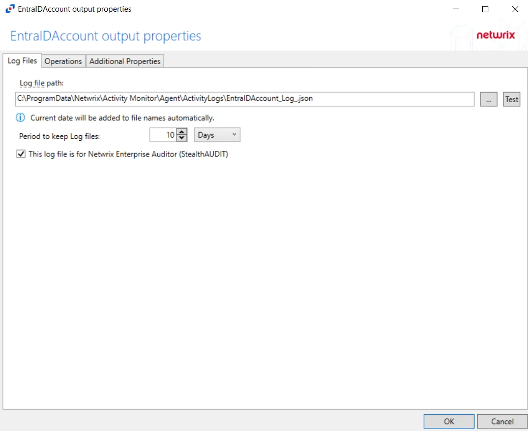

For Microsoft Entra ID, SharePoint Online, and SQL Server Hosts
Log File Tab - Azure Active Directory
    info

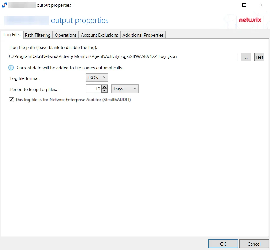

For SharePoint Hosts
Log File Tab - SharePoint On-Premises hosts
  • Log file format – Indicates the file type used for the activity log. The default is JSON. See SharePoint JSON Log File topic and the SharePoint TSV Log File topic for additional information.
    info
