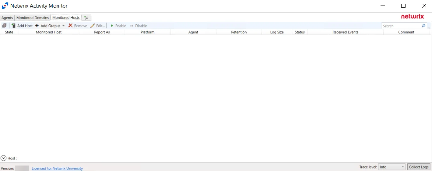

Tab
After agents are installed, hosts can be added for monitoring. The tab isn't visible within the console until at least one agent has been deployed.
This tab is comprised of a button bar and a table of hosts being monitored. A list of outputs is listed under each monitored host. These are destinations to which events are forwarded.
Button Bar
Use the button bar to perform the following actions:
Activity Monitor with Monitored Hosts tab identified
  • Toggle Collapse – Expands and collapses all Monitored Hosts for viewing or hiding host's outputs
  • Add Host – Opens the Add New Host window to configure monitoring of a new host or platform. See the section for instructions on adding the target environment you want to monitor.
  • Add Output – Opens the Add New Output windows to create new output for the selected host or hosts.
  • Remove – Remove the selected hosts or outputs from the monitored hosts table and end monitoring. A window prompts for confirmation to remove the selected hosts or outputs.
  • Edit – Opens the selected hosts or outputs’ Properties window to modify monitoring settings
  • Enable – Resume monitoring which has been stopped or paused
  • Disable – Stop or pause monitoring of the selected hosts or outputs
Bulk Actions
All actions in the button bar except Add Host can be used in the bulk mode. This means you can select several hosts or outputs and edit, disable, enable, remove them, or add new outputs at the same time.
Use bulk editing to selectively modify hosts or outputs. For example, with bulk editing you can add a user to Account Exclusions, set the retention period for log files, or disable reporting of Directory Read operations, etc.
To initiate bulk editing, select multiple hosts or outputs (Ctrl+A and Ctrl+Shift+A may help here), and click the Edit Edit button. The Properties window shows divergent settings as blank or in the unknown state or with the <-Different-Values-> marker for the list-like settings. Leave the <-Different-Values-> marker to preserve the difference in each selected object, or delete it to remove all divergent elements. When the window closes, only changed properties are saved to all selected objects, leaving unchanged properties untouched.

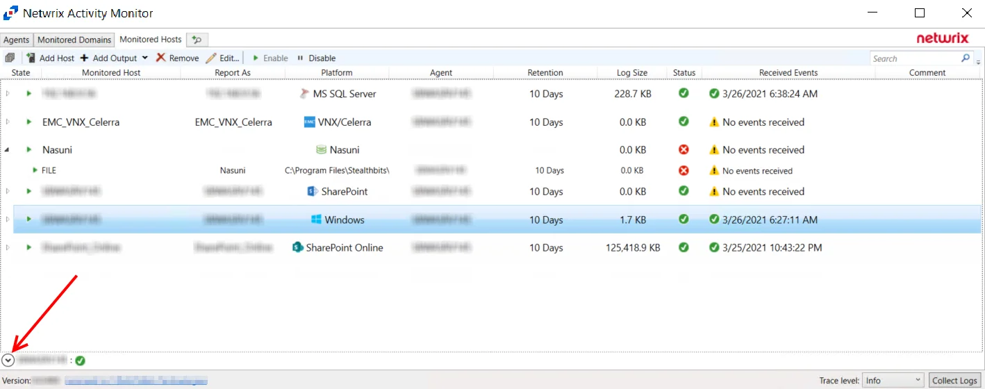

Table
The monitored hosts table provides the following information:
  • State — State of the monitored host. The two states are Enabled and Disabled.
  • Monitored Host – Name or IP Address of the host being monitored
  • Report As — How the Monitored Host is being reported as. This can be customized in the host's properties.
  • Details — Displays additional details about the monitored host, such as the Platform and the Log Path.
  • Agent – Name or IP Address of the server where the activity agent is deployed
  • Retention – Number of days for which the activity log files are retained
  • Log Size – Size of the activity log files
  • Status – Indicates the status of activity monitoring for the host. See the Error Propagation topic for additional information.
  • Received Events – Timestamp of the last event received
  • Comment – Comment provided by user:
    • Often this indicates the target output, e.g. Enterprise Auditor.
    • This can be useful if adding the same monitored host multiple times with different configurations for different outputs.
    • If a Activity Monitor Agent has been deployed to a Windows server where an activity agent is deployed, then the Comment identifies the host as “Managed by Activity Monitor”, and that ‘monitored host’ isn't editable. Add the host again for other outputs.
Hosts can have more than one output. To view a host's outputs, expand the host by clicking the white arrow to the left of the Monitored Host name.
For integration with Netwrix Enterprise Auditor, only one configuration of a ‘monitored host’ can be set as the Netwrix Enterprise Auditor output. After a ‘monitored host’ has been added, use the Edit feature to identify the configuration as being for Netwrix Enterprise Auditor on the Log Files tab of the host’s Properties window. See the Log Files Tab topic for additional information.
Monitoring Status
The Status collapsible section located above the Status Bar of the Activity Monitor provides visibility into a host's monitoring state and history of state changes. Host monitoring status is depicted in the Monitored Hosts table under the Status column. Users can expand the Status section to view more information on various status conditions.
errorpropogationpopulated
Click the Down Arrow to expand the Status section. The information listed is dependent on which host or output is selected in the Monitored Hosts table. Users can find information on the Current State of a host, as well as viewing a history of changes in state.
The possible statuses depend on the type of hosts being monitored. What is common is that the status can help identify a problem and provide a possible workaround. The following sections provide more information about device-specific states.
