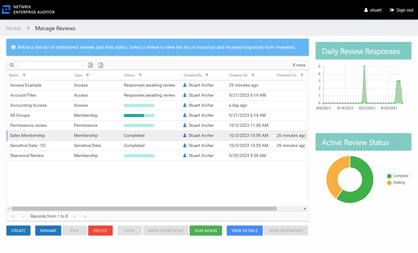

Manage Reviews page with completed review selected
On the Manage Reviews page in the Resource Reviews interface, a review with a Completed status can be started again. Select the review and click Run Again. The Create Review wizard opens without the Review Type page. The review can be run as-is by navigating through the wizard with the Next buttons, or you can modify as desired. Completing the wizard process restarts the review. See the Create Review Wizard topic for additional information.

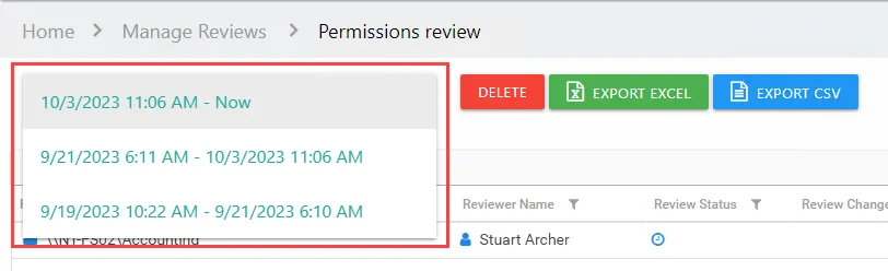

Instance dropdown on Review Details page
Previous instances for a review can be viewed on the Review Details page. Select the instance from the dropdown menu to show the details for it. See the Review Details Page topic for additional information.
