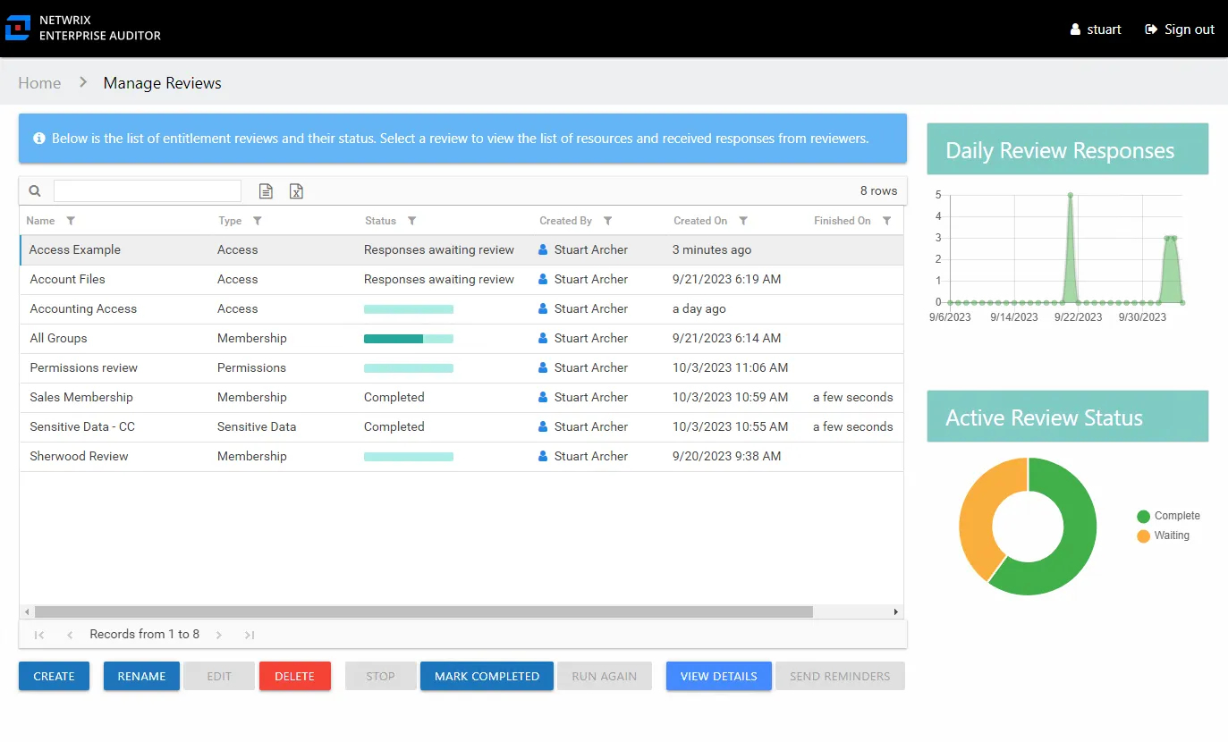

After all owners assigned to a specific review have submitted their review, its status on the Manage Reviews page of the Resource Reviews interface changes to Responses awaiting review.
Manage Reviews page with responses awaiting review

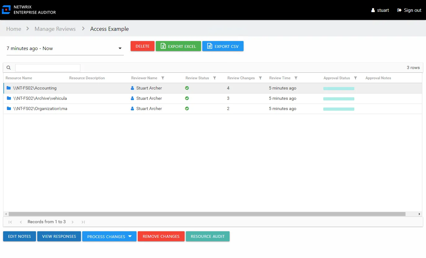

Step 1 – On the Manage Reviews page, select a review and click View Details. The Review Details page opens.
Review Details page for reviews awaiting processing

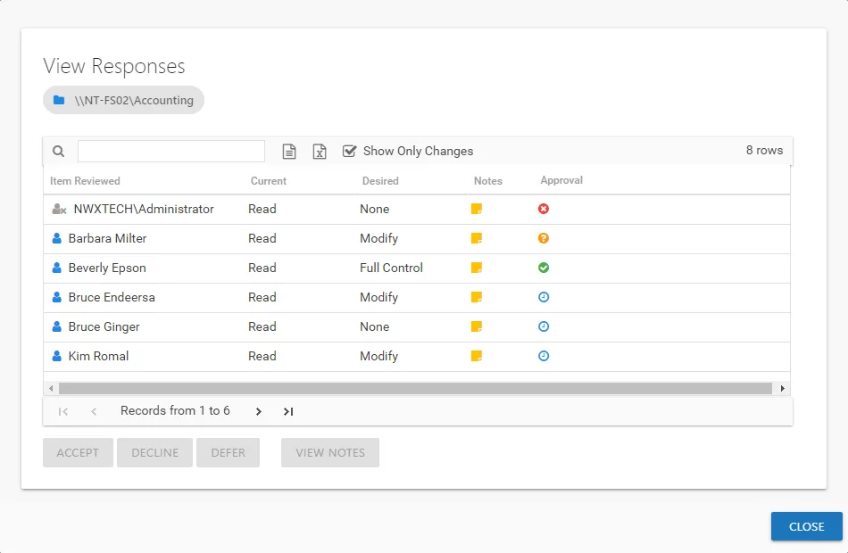

Step 2 – Select a resource in the list and click View Responses. The View Responses window opens.
Remember, the Resource Audit button opens the Resource Audit interface filtered to that resource's reports. This is where you can conduct change modeling.
viewresponses
Step 3 – By default, the table displays only the recommended changes. Select an item and click the desired action button: Accept, Decline, or Defer. The Approval column icon updates. See the View Responses Window topic for additional information.
Step 2 – Select a resource in the list and open the Process Changes drop-down menu. You can also select multiple resources in the list to be processed at once using the Ctrl and Shift key and click combinations.
