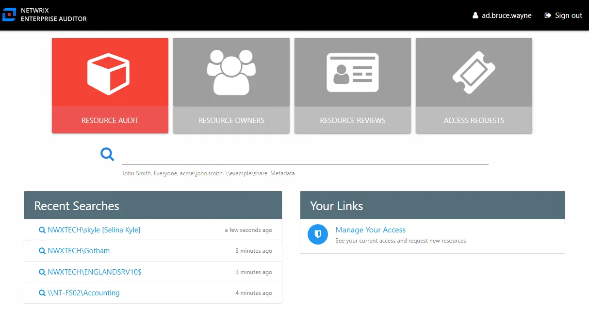

The audit interfaces are accessible from the home page of the Access Information Center.
Home page
The Resource Audit button opens the Resource Audit interface. The search features, which include a search bar and a Recent Searches box, let you open any audit interface.

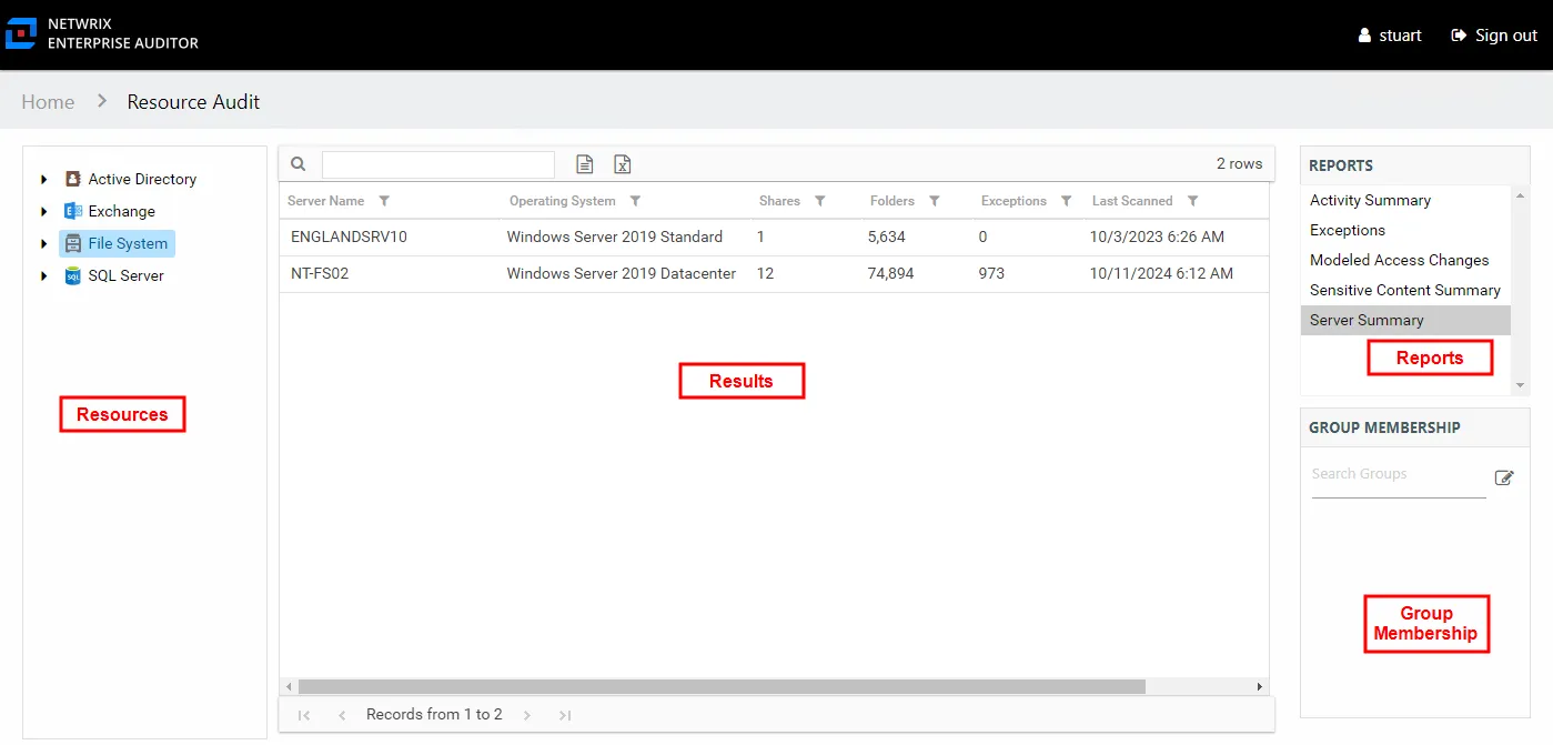

All audit interfaces consist of at least three components, and the Resource Audit interface includes a fourth pane.
Interface components
The main section of the audit interface is the Results pane. On the right-side of the page are the Reports and Group Membership panes. On the Resource Audit interface, the Resources pane is to the left of the Results pane. Theses panes have the following functions:
  • Reports Pane – Lists available reports for the resource type
  • Results Pane – Displays the report content
  • Group Membership Pane – Displays group membership for group trustees selected in the Results pane
  • Resources Pane – Navigation tree for the selected resource (only present in the Resource Audit interface)

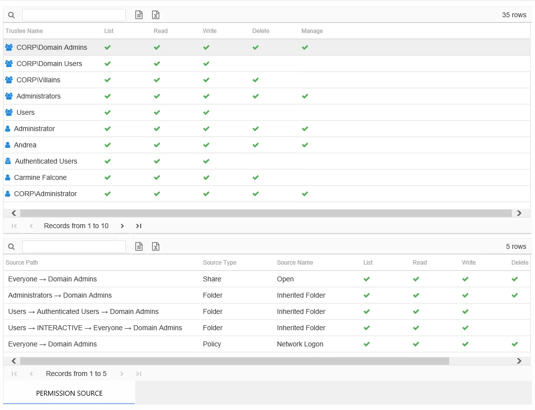

Results Pane​
The Results pane displays report data based on the selections in both the Resources pane and the Reports pane. Reports may consist of multiple tables and graphs.
Results pane
Tables and graphs that display at the bottom of the pane vary according to the selected report. See the Data Grid Features topic for additional information on table options. See the individual report topics for specific information on columns and displayed data for a report.
