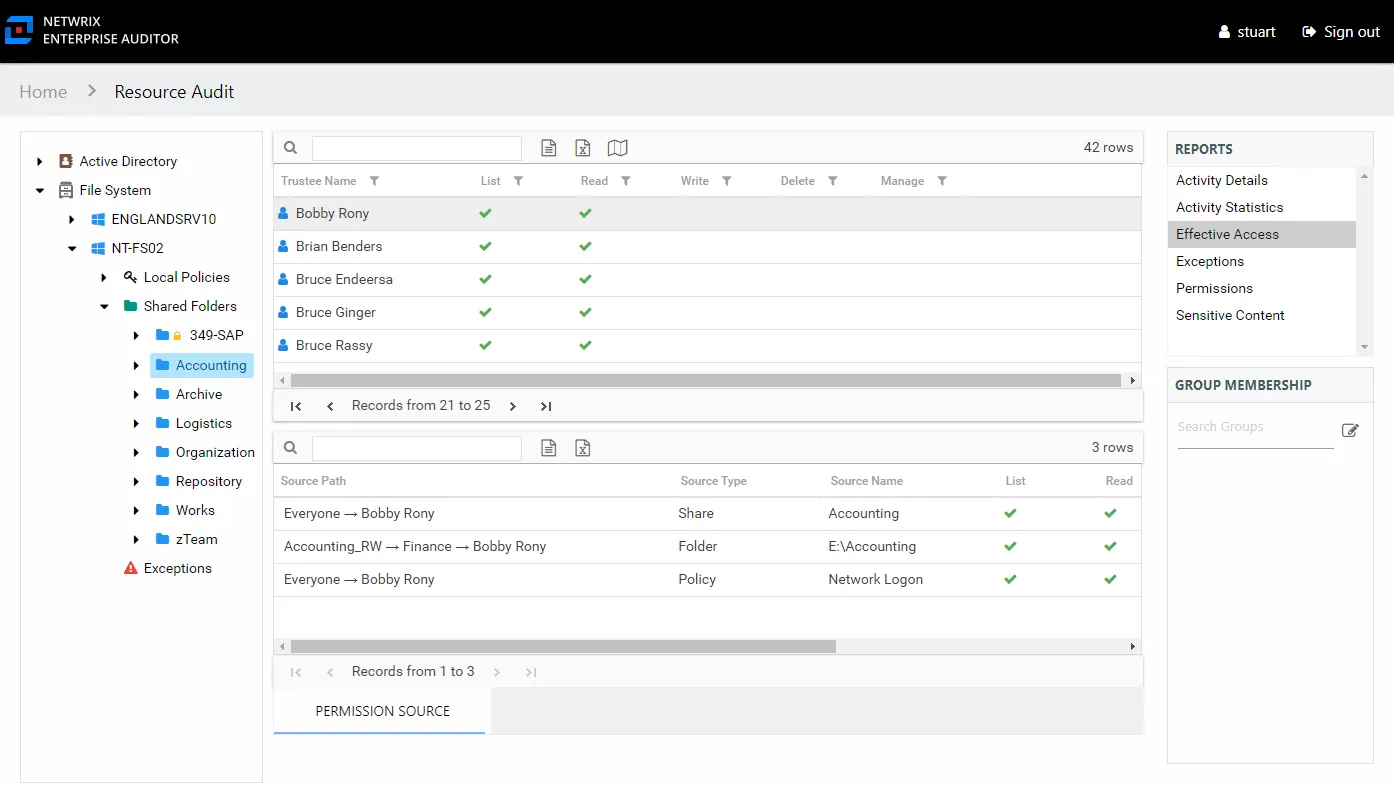

Step 1 – Navigate to a desired file system resource and select the Effective Access report in the Reports pane.
Select trustee on Effective Access report

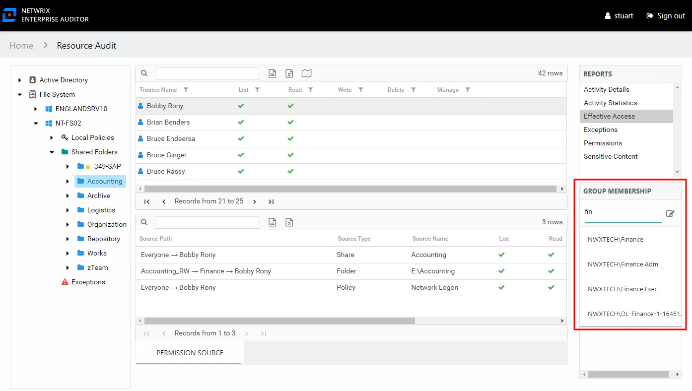

Step 2 – Select a trustee from the top table in the report. The Permission Source table displays the Source Path, or methods of access, to the selected resource. In this example, the trustee has access through three sources on policies, shares, and folders.
Select Group in Group Membership pane of Effective Access report
Step 3 – In the Group Membership pane, begin to enter the name of the group that grants the access to be changed. Select it from the list that shows in the drop-down menu. The group’s membership list opens.

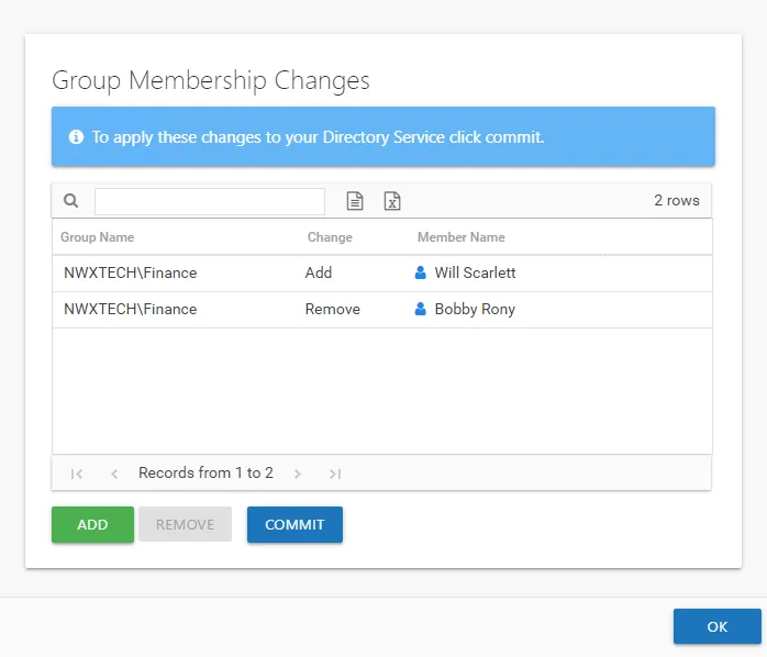

Step 4 – Click the Change Group Membership button on the Group Membership pane. The Group Membership Changes window opens.
Step 5 – If this is the first change being modeled, the table is empty. If other changes are being modeled, they are listed in the table. Click Add to open the Add Membership Change wizard.

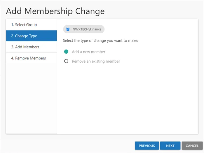

Add Membership Change wizard Change Type page
Step 7 – On the Change Type page, indicate the type of change to be modeled:
  • Add a new member – Opens the Add Members page. If you select this option, proceed to Step 8.
  • Remove an existing member – Opens the Remove Members page. If you select this option, skip to Step 10.
Click Next.

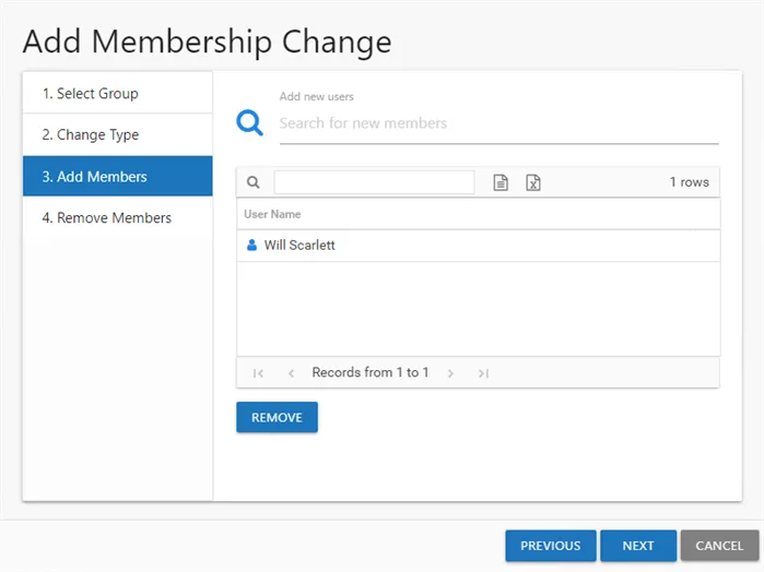

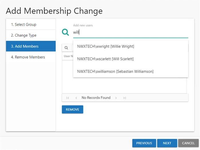

Step 8 – Begin to enter the trustee name in the search box. Available groups and users auto-populate in the drop-down menu. Select the desired trustee and the new member is added in the user list. Repeat as desired to add multiple members.
Add Members page User Name table
Step 9 – The members to be added are shown in the User Name table. Click Next. The Add Membership Change wizard closes, and the new members are listed on the Group Membership Changes window. Skip to Step 12.

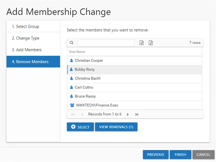

Step 10 – On the Remove Members page, the existing group members are listed. Select the desired members and click Select.
NOTE: The number on the View Removals button changes to reflect the number of users selected.
Members selected for removal window
Step 11 – (Optional) Click View Removals to view the members selected for removal. To remove a member from this list, click Remove and then click OK.
Step 12 – The members selected for removal are shown in the User Name table. Click Finish. The Add Membership Change wizard closes, and the members to be removed are listed on the Group Membership Changes window.
Group Membership Changes window with changes to be modeled
Step 13 – Repeat Steps 5-9 to model adding more members. Repeat Steps 5-7 and 10-11 to model removing more members. When the changes to be modeled are set as desired, click OK. The Group Membership Changes window closes.
