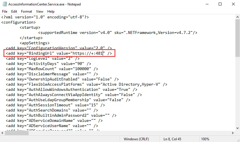

Modify the AccessInformationCenter.Service.exe.Config File​

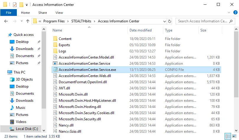

To modify the AccessInformationCenter.Service.exe.Config file for HTTPS:
Step 1 – Open the AccessInformationCenter.Service.exeWeb.config file in a text editor, such as Notepad. The file is located in the Access Information Center installation directory:
…\Program Files\STEALTHbits\Access Information Center
AccessInformationCenter.Service.exe config file
Step 2 – Change the BindingUrl key value to "https://+:481" (ensure the port number matches the port number used in the PowerShell command run to create the SSL Binding).
Step 3 – Save and close the file.
Step 4 – Navigate to Services (services.msc). Restart the Netwrix Access Information Center service.
The URL for the Access Information Center is now https://[Fully Qualified Domain Name for the Machine]:481/v2/login (if port 481 was used when creating the binding). For example, https://ENGLANDSRV10.NWXTech.com:481/v2/login.

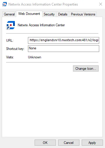

Update the URL in the AIC’s Desktop Icon Properties​
To update the URL in the AIC’s desktop icon’s Properties window:
Step 1 – Right click the Access Information Center desktop shortcut and click Properties.
Access Information Center desktop icon properties
Step 2 – On the Web Document tab, enter the updated URL in the text box to: https://[hostname.domain.com]:481/v2/login
Step 3 – Click Apply and then OK to exit.
The URL is now updated. SSL is enabled for the Access Information Center website.

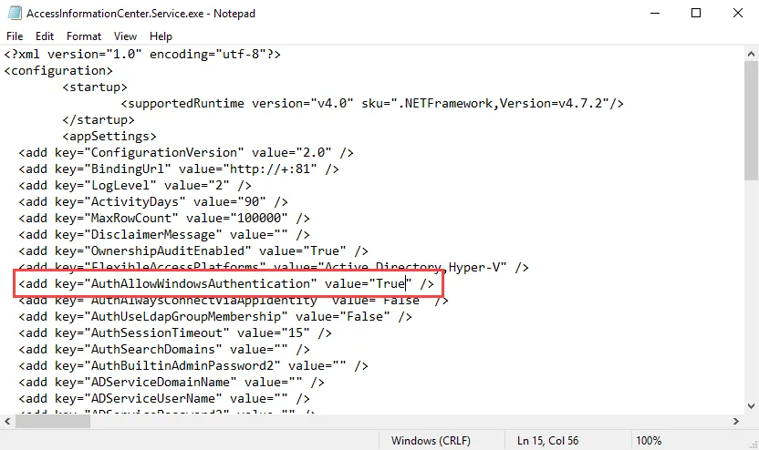

To enable SSO for accessing the Access Information Center website directly:
AccessInformationCenter.Service.exe config file in File Explorer
Step 1 – Open the AccessInformationCenter.Service.exe.config file in a text editor, such as Notepad. The file is located in the Access Information Center installation directory:
Step 2 – Locate the line containing the AuthAllowWindowsAuthentication parameter. By default, the value will be set to False:
<add key="AuthAllowWindowsAuthentication" value="False" />
Change the value for the AuthAllowWindowsAuthentication parameter to:
<add key="AuthAllowWindowsAuthentication" value="True" />
Single sign-on is now enabled for the Access Information Center.

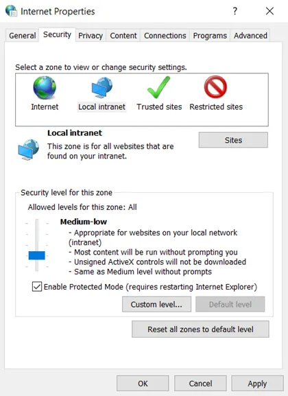

Local Intranet Settings​
Next, configure local intranet settings for SSO. This lets authentication pass through Windows Authentication and bypass SSO configuration prompts for credentials via browser pop-up.
To configure local intranet settings:
Step 1 – Open Windows Internet Properties (Control Panel > Network and Internet > Internet Options).
ConfigureLocalIntranetSettingsforSSO - 1
Step 2 – Go to the Security tab, and select the Local Intranet option. Then, click the Sites button.

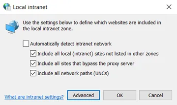

Step 3 – Click the Advanced button.
localintranetadvanced
Step 4 – Enter a domain in the Add this website in the zone field. Ensure the fully qualified domain name is in the following format: https://<server>.<domain>.com
Step 5 – Click the Add button. Close the Local intranet window.
