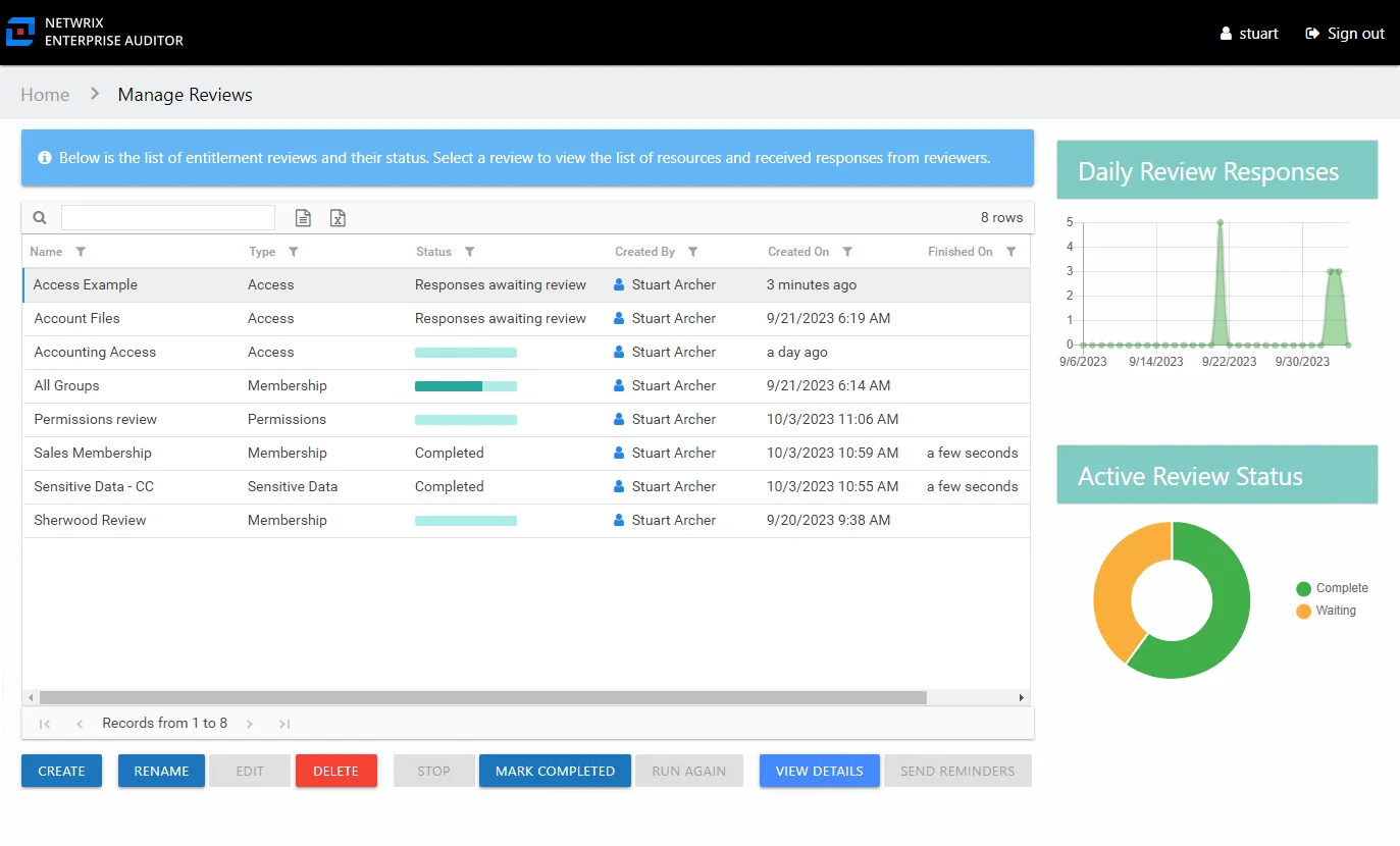

Approval Process
After all owners assigned to a specific review have submitted their review, its status on the Manage Reviews page of the Resource Reviews interface changes to Responses awaiting review.
Manage Reviews page with responses awaiting review
In the approval process, the Review Administrator looks at the owner-recommended changes and chooses to approve, deny, or defer the changes.

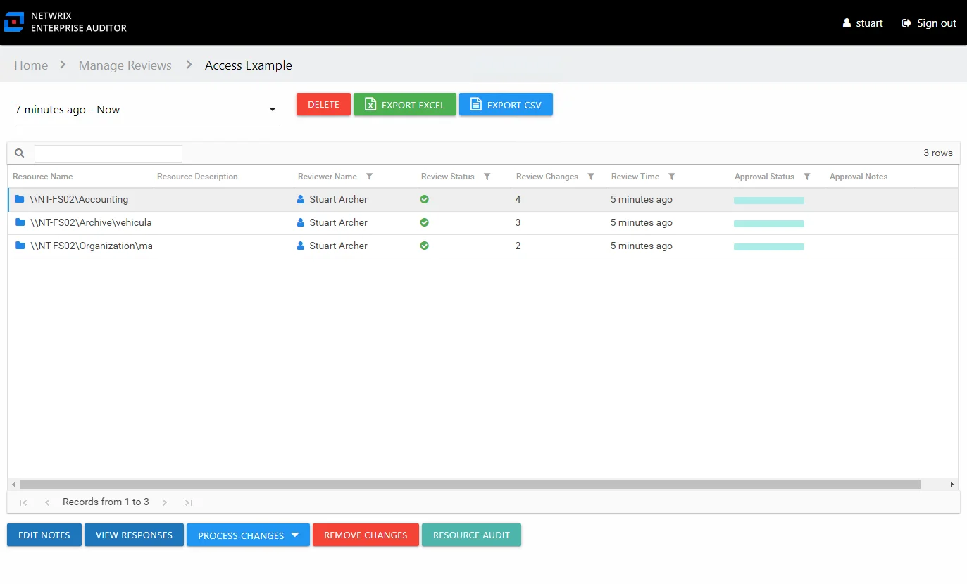

Step 1 – On the Manage Reviews page, select a review and click View Details. The Review Details page opens.
Review Details page for reviews awaiting processing

Step 7 – When remediation is complete, return to the Mange Reviews page (click the breadcrumb). Select the review in the list and click Mark Completed.
The review remains marked as Completed until the next instance is started.
Step 2 – Select a resource in the list and open the Process Changes dropdown menu. You can also select multiple resources in the list to be processed at once using the Ctrl and Shift key and click combinations.
