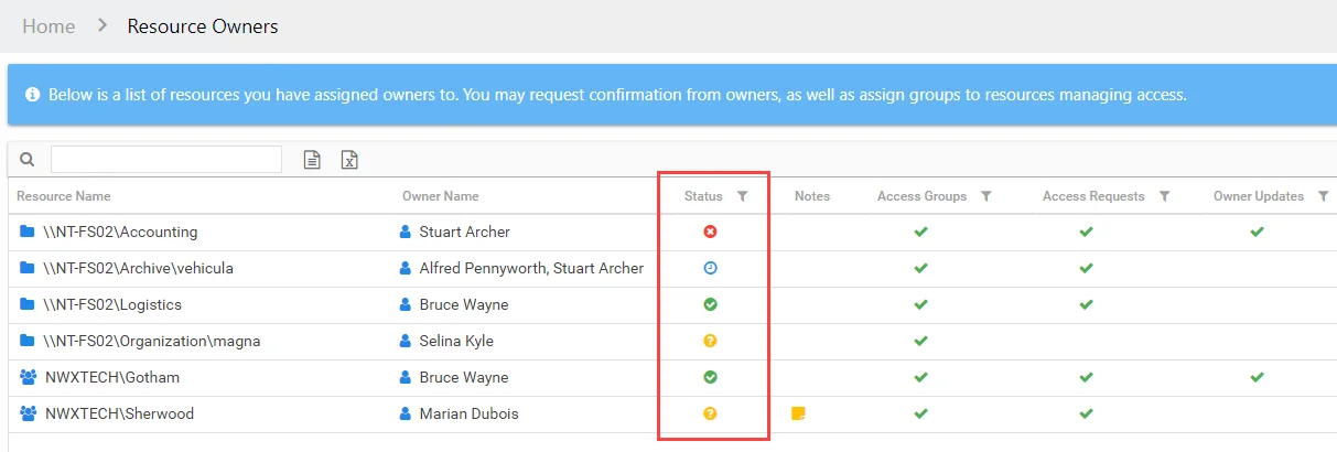

Status Column in Resource Owners interface
The table in the Resource Owners interface includes a Status column. The following icons appear in this column to indicate confirmation status:
IconMeaningDescription
Yellow circle with white question markNo StatusIndicates ownership confirmation has not been requested, and there is no ownership status at this time The exception is if ownership was automatically confirmed with the Import Owners Wizard.
Blue circle with white clock faceWaitingIndicates a request for confirmation has been sent, and you are waiting for a response from the assigned owner. Hover over the icon to view the date timestamp of the request.
Green circle with white checkmarkConfirmedIndicates the assigned owner confirmed ownership of the resource. Hover over the icon to view the date timestamp of the confirmation.
Red circle with white XDeclinedIndicates the assigned owner declined ownership of the resource. These individuals would have been asked to suggest an alternative owner. Check the Notes for the resource to view this information. Hover over the icon to view the date timestamp of the decline. Remember, a resource with declined ownership needs to be updated to assign a new owner. See the Update Resource Wizard topic for additional information.
If multiple owners have been assigned, there is a choice for which assigned owner(s) should receive the confirmation. If multiple owners were sent the request, the column remains as a waiting symbol until the assigned Primary owner replies.
