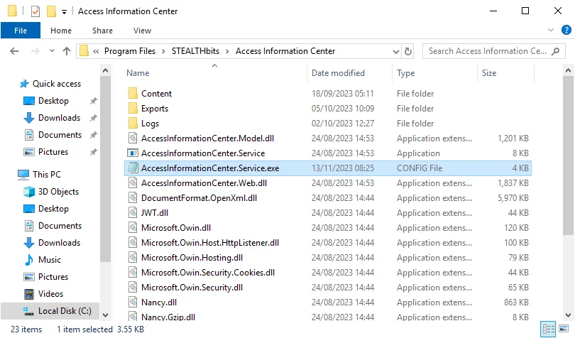

Step 1 – Open the AccessInformationCenter.Service.exeWeb.config file in a text editor, such as Notepad. The file is located in the Access Information Center installation directory:
…\Program Files\STEALTHbits\Access Information Center

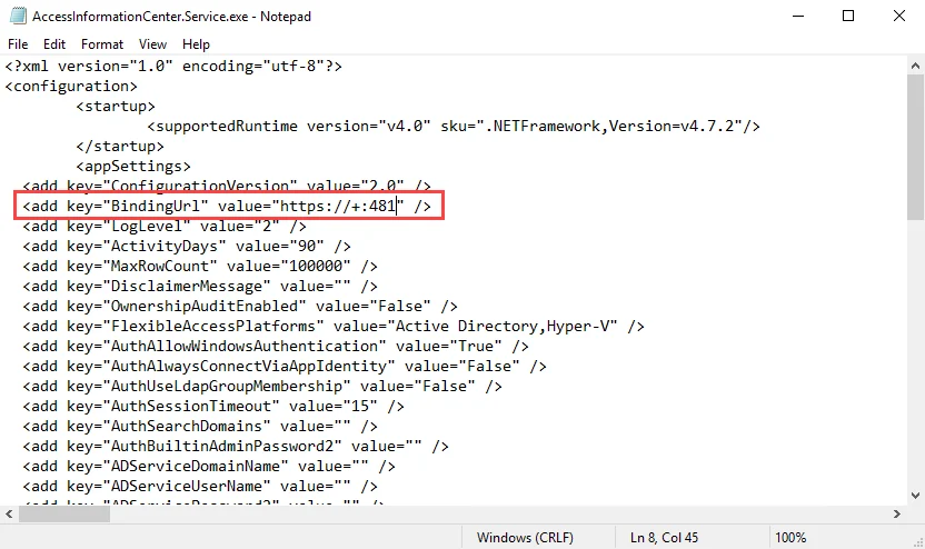

Step 2 – Change the BindingUrl key value to "https://+:481" (ensure the port number matches the port number used in the PowerShell command run to create the SSL Binding).
Step 3 – Save and close the file.
Step 4 – Navigate to Services (services.msc). Restart the Netwrix Access Information Center service.
The URL for the Access Information Center is now https://[Fully Qualified Domain Name for the Machine]:481/v2/login (if port 481 was used when creating the binding). For example, https://ENGLANDSRV10.NWXTech.com:481/v2/login.

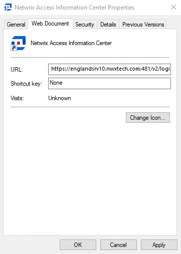

To update the AIC's desktop icon's Access Information Center's Properties window:
Step 1 – Right click the Access Information Center desktop shortcut and click Properties.
Access Information Center desktop icon properties
Step 2 – On the Web Document tab, enter the updated URL in the text box to: https://[hostname.domain.com]:481/v2/login
Step 3 – Click Apply and then OK to exit.
The URL is now updated.

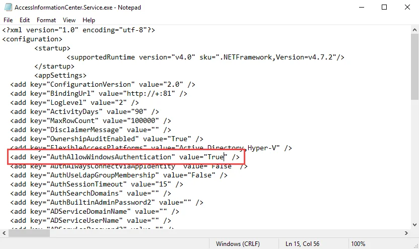

Step 2 – Locate the line containing the AuthAllowWindowsAuthentication parameter. By default, the value will be set to False:
<add key="AuthAllowWindowsAuthentication" value="False" />
Change the value for the AuthAllowWindowsAuthentication parameter to:
<add key="AuthAllowWindowsAuthentication" value="True" />
The Access Information Center has been enabled for single sign-on.

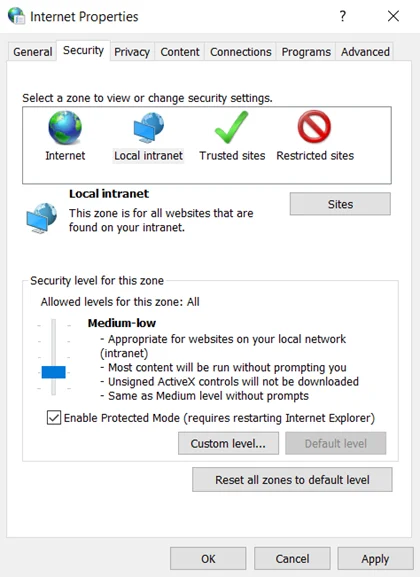

Step 1 – Open Windows Internet Properties (Control Panel > Network and Internet > Internet Options).
ConfigureLocalIntranetSettingsforSSO - 1

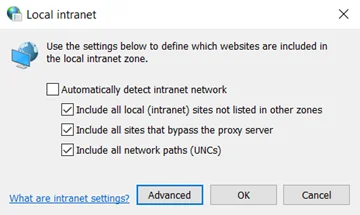

Step 2 – Go to the Security tab, and select the Local Intranet option. Then, click the Sites button.
localintranet
Step 3 – Click the Advanced button.
localintranetadvanced

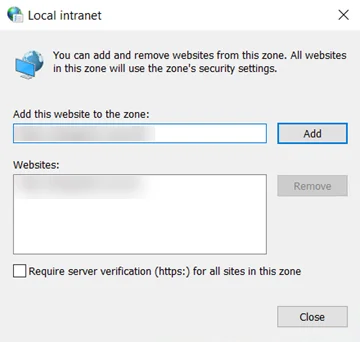

Step 4 – Enter a domain in the Add this website in the zone field. Ensure the fully qualified domain name is in the following format: https://<server>.<domain>.com
Step 5 – Click the Add button. Close the Local intranet window.
Step 6 – On the Internet Properties window, click the Apply button.
