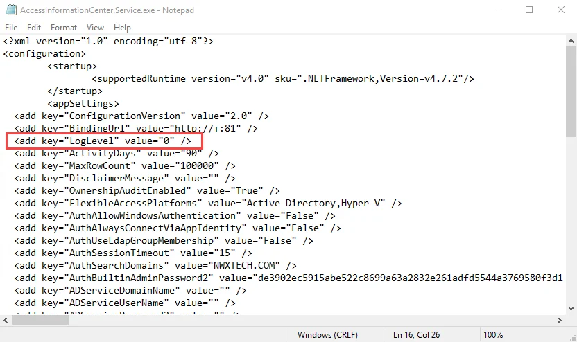

Step 1 – Open the AccessInformationCenter.Service.exe.config file in a text editor, for
example Notepad.
Step 2 – The level value is set in the LogLevel parameter, where 0 is the default level. As
the logging level increases from 0 to 3, the types of information and level of detail included
within the log file also increase. Change to the desired log level:
<add key="LogLevel" value="0"/>

Step 3 – Save and close the AccessInformationCenter.Service.exe.config file.
Once troubleshooting has finished, it is recommended to return the log level to the least verbose level, Error = 0, to prevent the log file from growing too large.
